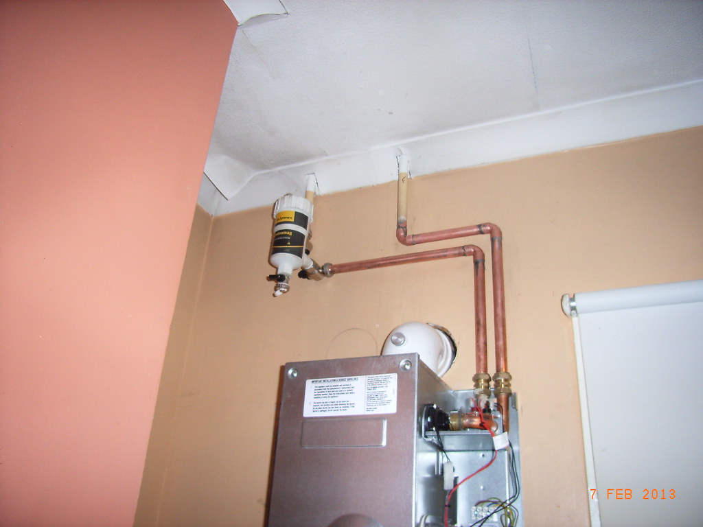

I'm trying to be a bit neater on my installs and am willing to see what you all say this time.
Here's something's I think you'll say so ill address them first
Why is?.......
Hot and cold so far apart
Who is hot below the cold
Why is hot leading into a 22mm pipe
Why is line beater crooked
Why is there a diff coloured compression on limbeater
So the answers are
A. To prevent cold being warmed by hot
B. So I didn't have to cross over
C. Customer didn't want to pay for us to put it all in 15mm to bathroom
D. Didn't realise it was to be honest. Seemed fine earlier.
E. Because the 22mm version is £15 in Travis clearance. Throw the 22-15 coupler in the box and use what you have.
[/QUOTE]
Did you managed to fit this short length OK? Or you got yourself in the corner!?
After fitting the short length and running boiler there were two rads that didn't get warm in the house.
A bit of head scratching and I connected the 3rd pipe(middle between f n r) into the return and it all ran lovely!!
So in the end it looked a bit different anyway.

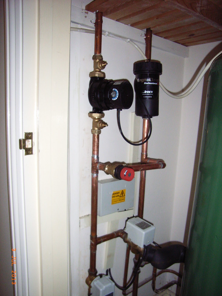

Image033.jpgi think this thread should be stickied where all installs can have a bit of constructive criticism. go on then sok it to me..
View attachment 16938i think this thread should be stickied where all installs can have a bit of constructive criticism. go on then sok it to me..
too many pulled bends in close proximity to each other if i was splitting hairs and also see no advantage to using 2 tundish and the one from the boiler is pretty much guaranteed to over flow should it go.
not too many bends as in more then needed, but as in it all looks very busy in a very close area everyone would have a different take on someone elses work. its just how youd do it differently.
My mentor hates my pipework and would never let me take the glory job but then im not a fan of his pipework or clip choice etc etc just personal opinion TB
Just personal preference really. Personally I think soldered elbows look nicer than pulled 90's. Keeps everything looking nice and square and tight.
Looks nice but hydraulically it's horrid.

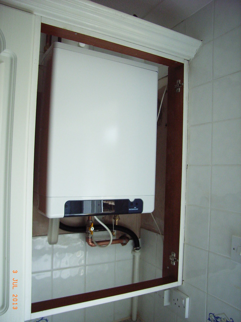

Clips few and far between below boiler. Prv tun-dish - not pretty also filling loop inconvenient. Where is your wiring center going can't see a where nice within 1m of two ports.
mfgs the cupboard is deeper then it looks. and there is a verticle flue on it with no ceiling in that cupboard as the roof leaked a few years back
I think bends look like the installer knows what they're doing.
i can see your very protective over your bender, and i agree pulled bends do tell other plumbers that. but so can a soldered joint with no snots or runs, i wouldn't dream of buying a soldered crossover as the ones made with a bender look neater so do kicks off sets and shepherds hooks, but personally in a bank of pies i prefer tight bends
i guess we beg to differ
hahaha go on lads. yes i agree with the clip issue. imho square bends unless its internally/external corners ( in my fathers words "the more joints the more potential leaks, and if you don't see bends the plumbers crap")😉.
i was always told if you use one pulled bend use two pulled bends, etc etc what ever happened to JOTM?? that's where everyone used to post pictures of their master pieces and to fair there were one or two howlers in there.
Not at all. I can see both points of view! and yes, elbows can and often do look neater.
didnt understand the one pulled bend use two pulled bend thingy..
trying to keep it uniform rather then alternating between bends, not aiming it at anyone or thing just when you mentioned what the old man taught you regarding the use of bends that came flooding back from my early days right before i was made to rip out every solder joint id done and replace it to match all the pulled bends
nice offset on the erm cold i think. Would have put a clip closer to the offset .fair play for uping one.
