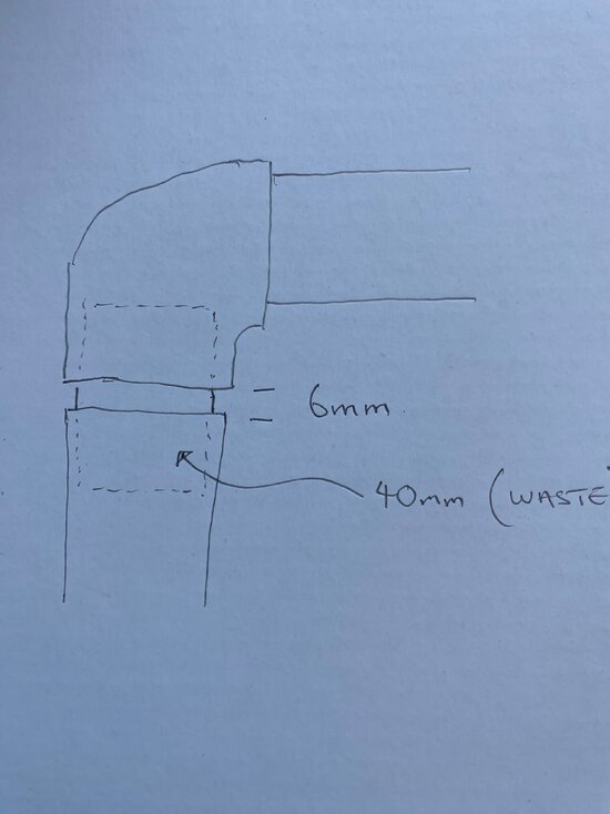

Hello,
To get me out of a situation where I don’t have much p-trap headroom even with an adjustable trap and cutting the waste to lower it would be very difficult.
Consider replacing the standard 90° bend you've drawn with a '40mm 90° conversion bend' and a '40mm coupler'. You might have to shorten the longer leg of the conversion bend but you'll have the 6mm+ you need to work with.
Measure and check everything three times before using the cement, you'll only get one try!
