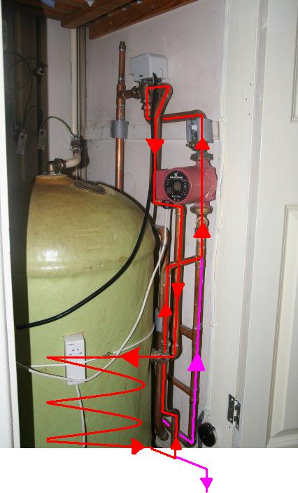

looks like the feed and vent are the wrong way round. swap them over, lower pumo below the bypass(wrong side of pump) and fir auto by pass valve. should fix problem

A Y plan (your system, with a mid position valve) does not under most circumstances, need a bypass.
As they have fitted one to the wrong side of the pump it is causing the water to short circuit with most of the water following the red line where it should follow the pink line back to the boiler. When on for CH only the bypass is cut out of the circuit and if on for HW and CH it won't effect it as much.
Close the bypass by turning the screw on the silver valve so that it is across the pipe.

tamz has pretty much described the problems there for you. you can shut off the bypass which should sort the issue or better still resite it. yes in most cases it doesnt need a bypass as there is always a route for the water unlike an s but it is recommended
Thankyou! I 100% understand what you guys mean now having seen the above diagram. OK, so the chrome valve on the bypass...which way should I turn it to close it? I assume clockwise? It was at horizontal i.e. 9 and 3 O clock, and I turned it a quarter of a turn clockwise to 6 and 12 O clock and it started dripping as I turned it. It got stiff after a quarter turn clockwise so I stopped, but I think I could turn it more. Should I force it till it won't go any further or is a quarter turn enough? I don't think it is closed but not sure. Thanks all for the help so far. Also, I noticed with HW and CH on, I still think it knocks a bit. It is quietest when just CH on which would fit with info above as bypass not used then. It is def air in the pipes. Can tell by the way the pump sounds and behaves.
if the line on the top is in line with the water flowing its on. if its adjacent it is off, just use a slottede screwdriver to turn it the correct way

In that case then, it was already off as it was going accross the pipe before I adjusted it 🙁
I just turned it 180 degrees the other way to the off position to see if it made a difference. Not sure why it leaks when I turn it. Anyway, I turned the HW on on its own and so far it has not knocked. However, I think the knocking usually occurs only when the HW first starts up having been off for a while. First thing in the morning does seem worst (6:30am), however, it does do it in the afternoon when it comes on again around 3pm sometimes. I will test it tomorrow morning and see if anything has changed. Thanks for all your help.

Probably is Fuzzy, in which case the neutral point being the feed will mean it will draw air.
Easiest fix is change it to a feed expansion.

Hey guys, I think I need another few morning to monitor this to be sure this is not a fluke, but this morning it didn't knock. It was quiet as anything. Well...just the pump noise with no air knocks. Maybe when I turned the bypass valve the other way this time it shut it off properly and it wasn't fully closed last time? Maybe to do with it leaking when I turn it not sealing properly? I will let you know what tomorrow is like 🙂

I think the knocking may have gone away! Touch wood.
