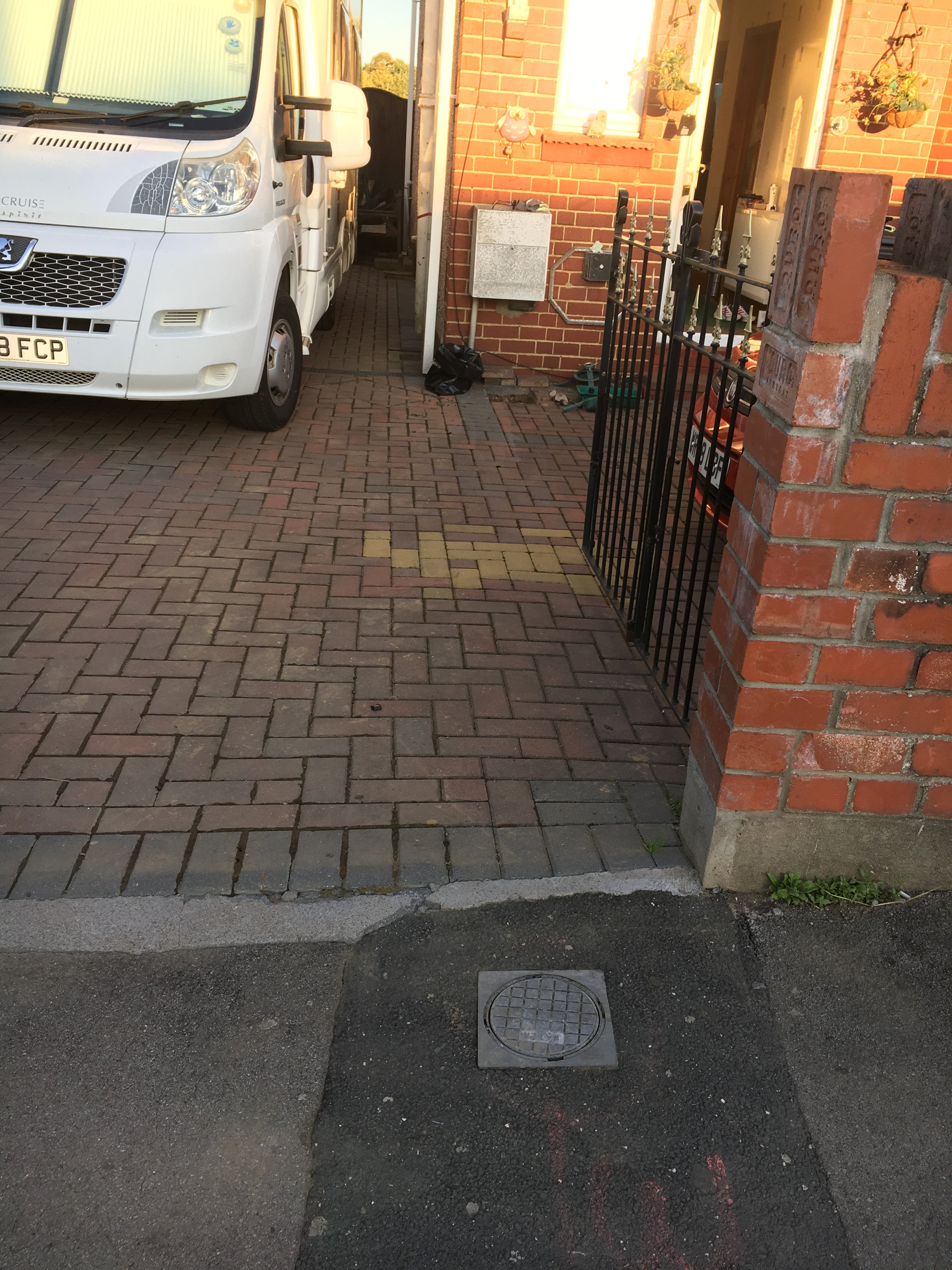

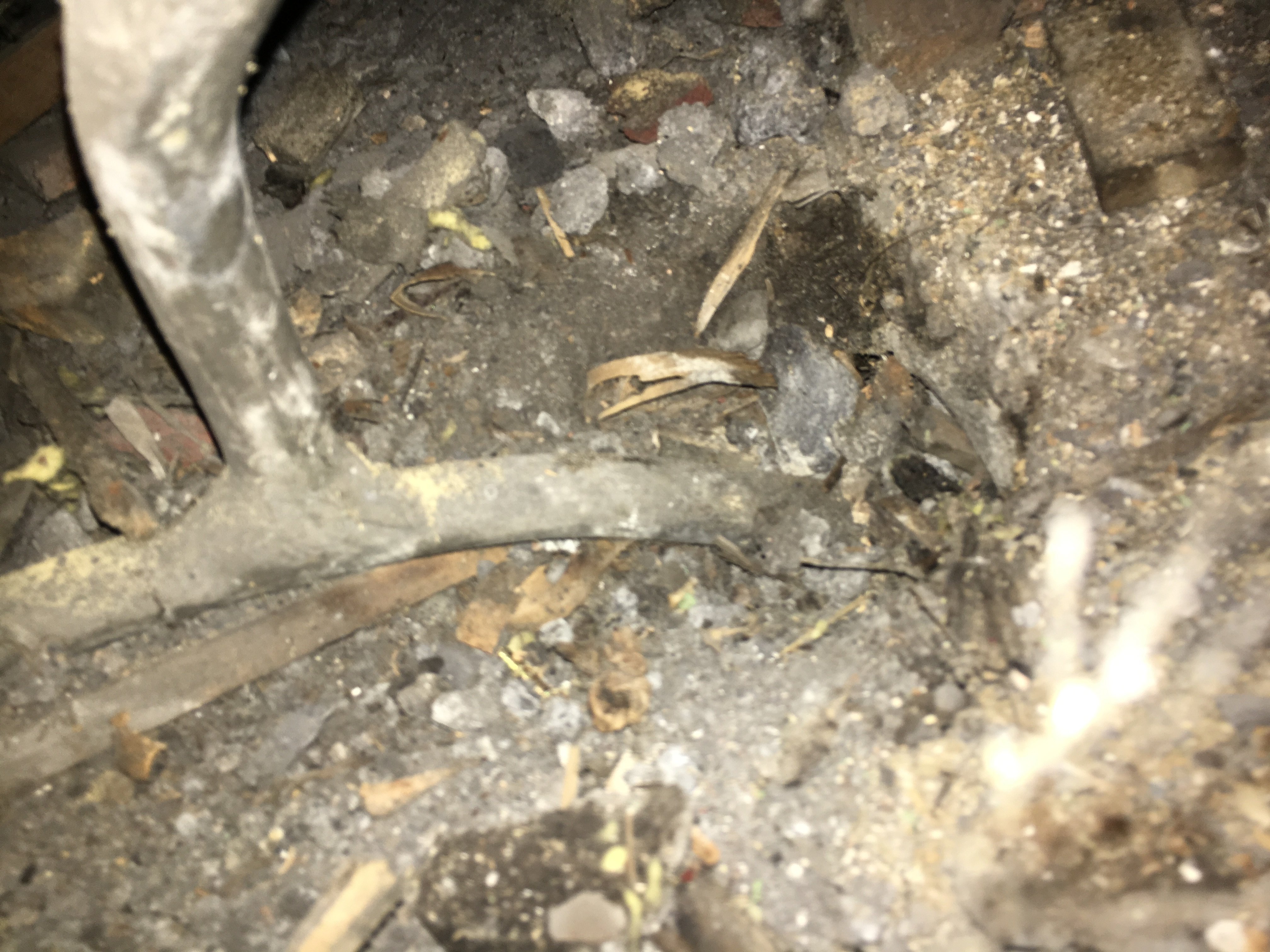

ok new to this forum and plumbing so be gentle. It’s my house not a rental, the distance from the lead pipe to the water meter is about 5 meters under a recently paved drive. The lead passes through the footings somehow, so not sure how to replace this! The house was built in 1910 so is last century, but I’m not made of money so will have to do the best I can with funds available and my own hard work 😓 how far down do I have to dig to find the pipe and can I connect dia blue pipe( whatever that is?) to the meter or do I have to get the water board to do that? Sorry for the ignorance, I’m trying to learn as fast as I can!

If your meter is connected to the lead, then your water undertaker (water board) may offer a free lead replacement scheme whereby they’ll connect onto the meter/boundary free of charge. To expose the lead, which judging by one of your pics, looks like you may have found? You just need to dig down, not sure if these were laid to any minimum depth. For your blue MDPE/new pipe, it has to be laid to a minimum of 750mm and a maximum of 1350mm. Also looking at a photo you need to keep next doors connected from that tee. There’s always moling, not sure of costs though.
Thank you for the info will keep digging! , Is the other pipe for next door? The lead pipe that feeds both tee’s comes from my meter?

Unless you have x2 feeds, eg outside toilet, or this has been capped, then I’d say it’s for next door - in which case having an external meter maybe costing quite a bit. Turn water off at meter, engage with next door and see if their water turns off?

Just an update on my issues. Thank you all for your help, it’s been very informative and useful. To reply to some of the questions asked if me:
the lead pipe dividing at the point of ingress to my house is in fact to upstairs( where the stopcock has been fitted, and to downstairs ( no stopcock able to be fitted as only an inch of lead above ground before split then runs along soil under flooring)
I got a drainage man in ( friend of a friend)who capped off the house supply to prove the leak was under the drive where I had started to dig. He dug Dow much further to expose pipe and then suggested replacing the lead pipe with a new blue one instead of having to dig down 4 feet al the way along the drive throu the bricks and rocks that was my drive bed! Three hours later it was all done and back filled much to my joy! Just the pavers to replace now. I have to realise that sometimes it’s just out of my hands and this was one of tjosd occasions. He’s coming back to help me sort out the lead in the house too sometime.
