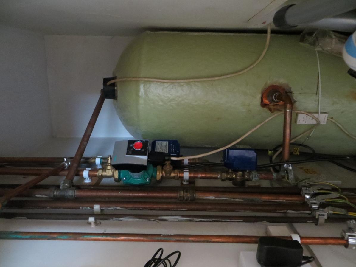

The pump and valves are in the airing cupboard together with the hot water storage tank. By-pass radiator in the hall 4m away from room thermostat. All other radiators have 2-way TRVs fitted, some on the flow and some on the return.
The boiler, a mynute VHE, is on the kitchen wall around 7m away from the pump.

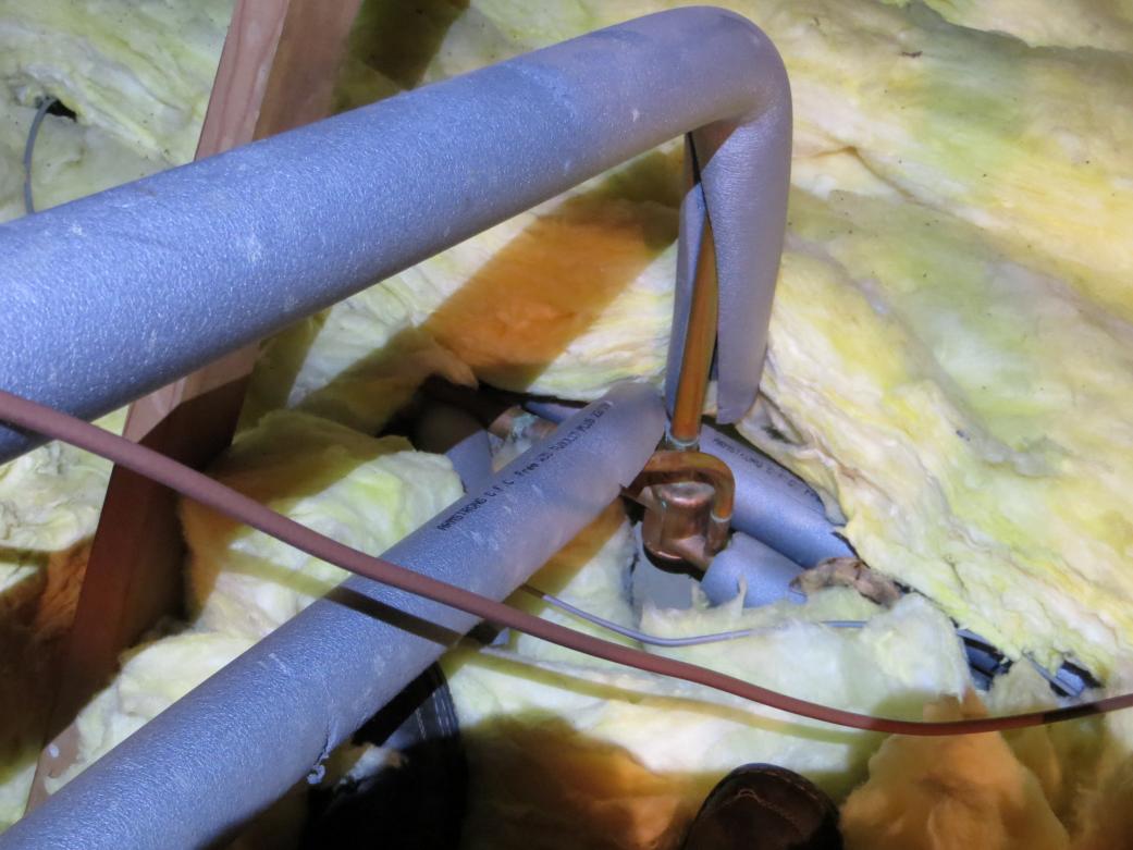

There is one manual air vent between the boiler and the air separator along return to the boiler, located in the loft and at the top of vertical pipework (hell of a job to get to)

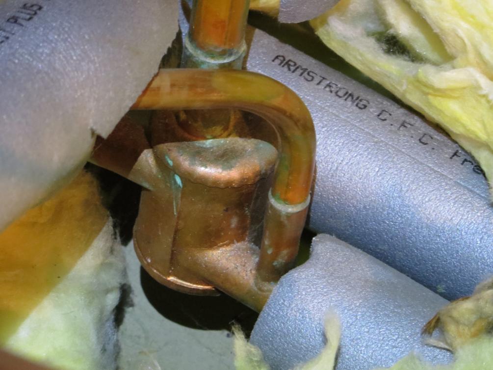

An air separator (with a separate cold feed inlet port) lies in the loft between the boiler and the pump on the flow. This air separator has been fitted standing up rather and length wise. All of its connections to the ports are correct: to pump, from boiler, to vent, from tank.

The air separator is attached to the expansion tank using 22mm copper and at the air separator 15mm, somewhere it changes width. The separate vent pipe is also 22mm copper and its bend is more than 50cm above the expansion tank.
The bottom of the expansion tank is 1.3m above the pump. The pump is 80 cm below the level of the air separator.
There is 60cm in height between the air separator and the bottom of the expansion tank (tower separator diagram gives 1m as a minimum).
The pump (wilo variable type Yonos PICO) is pumping down to the valves. I realise that pumping down should be avoided to reduce the chance of air getting trapped in the pump, which in my case is very often, but I can see why the installer has done it for convenience. As it is pumping down I would think that is the reason why the air separator has been installed.

Magnet and check cold feed is not partially blocked.
My very strong magnet (from a PC hard drive) does stick to most of the flow pipe upto and including all around the air separator, including around the cold feed port.
It had already a week of corgi system cleaner going through it.
Should I add boiler descaler in the system or will it be a waste of time?
Problem not limescale but iron oxide as confirmed by magnet test. Cut out and clean/replace. System will work without separator if suitably arrangement of pipework is possible.
