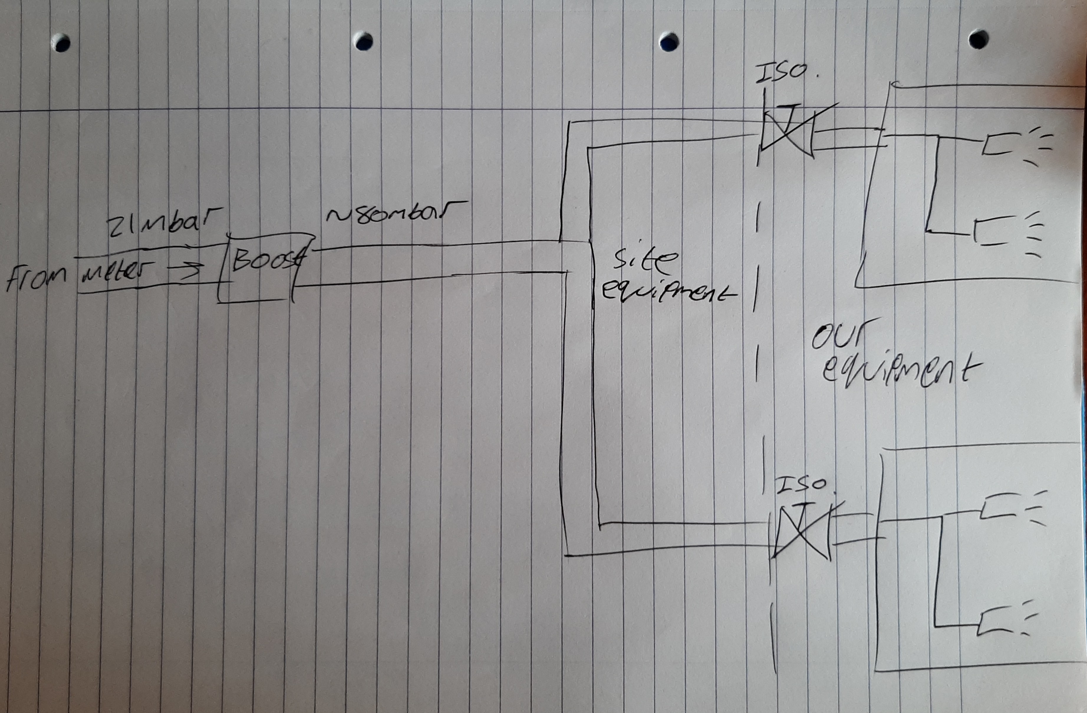

Here is a crude drawing which may explain better than I can. Not included all controls etc, just wanted to illustrate the dividing line between what we class as theirs and ours.
correct from the iso is your plant / equipment / remit
if you break into the gas line on your appliance / kit still going to need to either make sure its safe (your fine with this as your qualification covers this) and test the install if lets say you install a new gas / reg valve also purge the supply depending on where its located in the chain
so i would say at a min Gas installation pipework (ICPN1), Pipework testing and purging (TPCP1a) this would enable to install and correctly test and sign off from the iso valve forward into your plant
in my opinion best people to ask is gas safe
