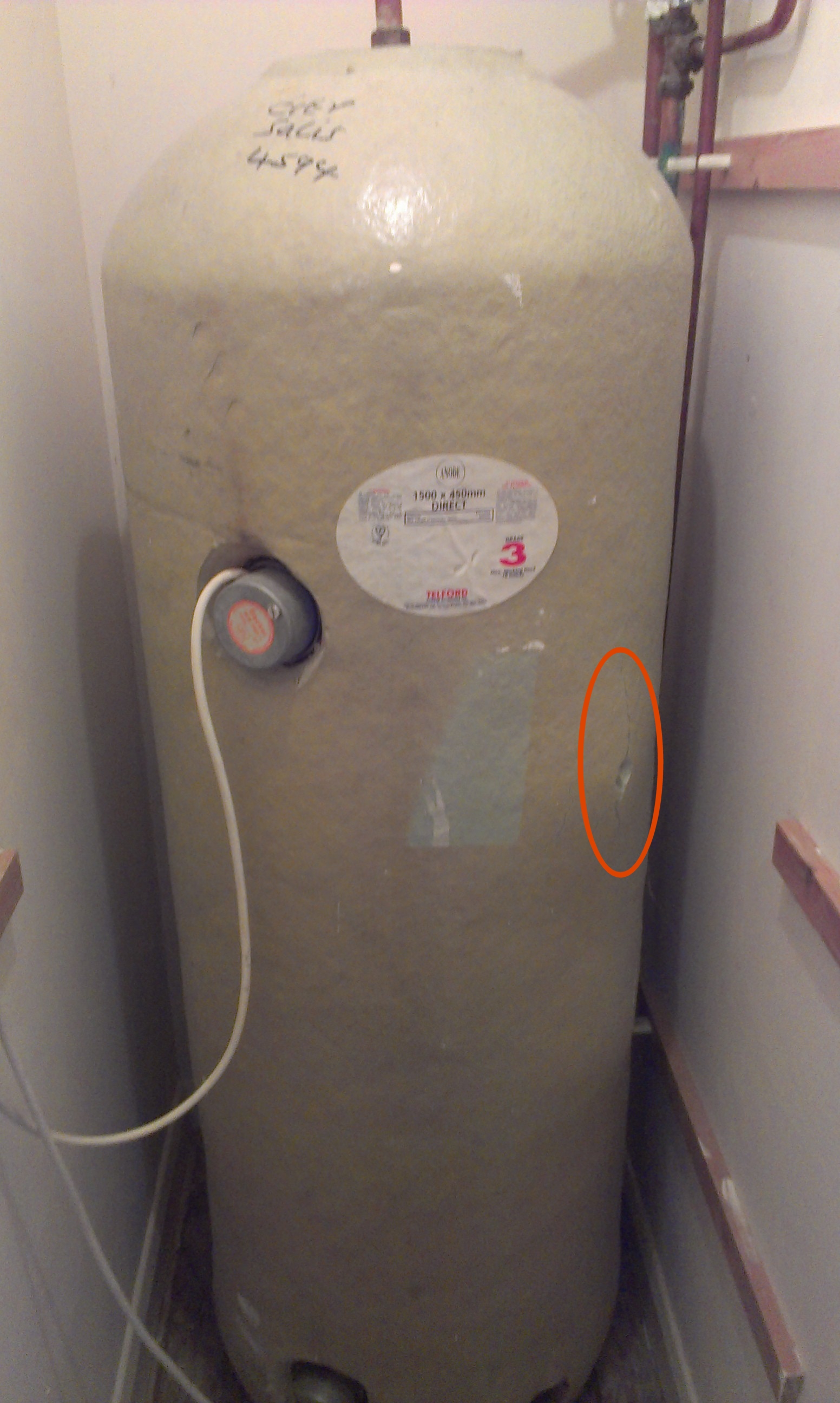

My immersion heater has stopped working (fuse trips when I switch it on). I was planning to check/replace elements myself but having had a look at cylinder, fear problem may be more serious.
The cylinder foam is distorted and cracked in two places. The foam bulges out perhaps 1cm around the cracks
(The hole is the result of me investigating)
Does this suggest the cylinder has had it? Before the immersion packed up, it was slightly noisier than usual.
All advice much appreciated.
Fact is, if the foam is delaminating it is not insulating.
Modern cylinders, especially if you specify 'economy 7' foaming have insulation that's a good twice (prob closer to 4x) as efficent as the old one you have.
At the ever rising price of energy I believe you'll be paid back in energy costs never mind peace of mind.
Oh I forgot. Often the element is impossible to remove without damaging the cylinder.

change immersion first see what happens..do you know how to do an immersion ?
centralheatking
Reactions: WesternPathfinder
I've never replaced an element before, but having done some research and seen what's involved, it's a job I'm willing to tackle.
ok....centralheatking guide to changing immersion heater element...others will chip in
turn cold water supply off to cylinder, let a couple of litres water out of hot tap. Leave rest of water in cylinder to keep it strong. turn lecky off and undo the 3 wires then with proper immersion box spanner undo immersion, it will resist,,, smart tap with decent hammer.
a little bit of water might appear as you undo unit. remove unit ...measure it and or go to plumbers merchant not bq get like for like plus a new stat. and small tub of boss white. smear boss white on thread carefully hand twist unit back into cylinder then nip up with box spanner. turn water on check for leak. re connect wires switch on listen to unit heating up. check temp and adjust thermo as required . sit down pat self on back open 1st of 4 beers bought on way back from plumbers merchant

Hello Rob,
I know that You have just missed this when writing your `Guide` to replacing an Immersion Heater - I am not `being funny towards You` - but just in case the OP does exactly what you wrote:
As the OP`s Immersion Heaters are on the side of the Cylinder He will need to drain off more than `let a couple of litres water out of hot tap` or he will be in trouble when the Immersion Heater is unscrewed.
OP / WesternPathfinder - You will need to drain the Cylinder to below the Immersion Heater point before unscrewing it.

Stabilising the cylinder is very important. That top immersion could be doable, but the bottom one looks like it will be a real hunt to remove. Depends if you’re wanting to use economy 7, if not and your doing it yourself, drain it just below the top immersion and carefully slack it off, make sure you have plenty of dust sheets down. If water starts to come out you will need to tighten it back and drain a bit more out. if it were me I’d be replacing the cylinder.

Also your cylinder immersions are side entry so once you have got the immersion cracked(moving) drain it from the drain point to below the immersion level. (Scoop out any scale if there is any when you change it and make sure you get the right type of immersion for your water hardness)

I had one to change a couple of days ago. Ancient direct cylinder and had to apply heat. Also a poor fit as there was no DOC so had to get as low as possible with the hot taps and then wrap with towels to catch the remaining water. Luckily it was a 27” top fitted heater.
