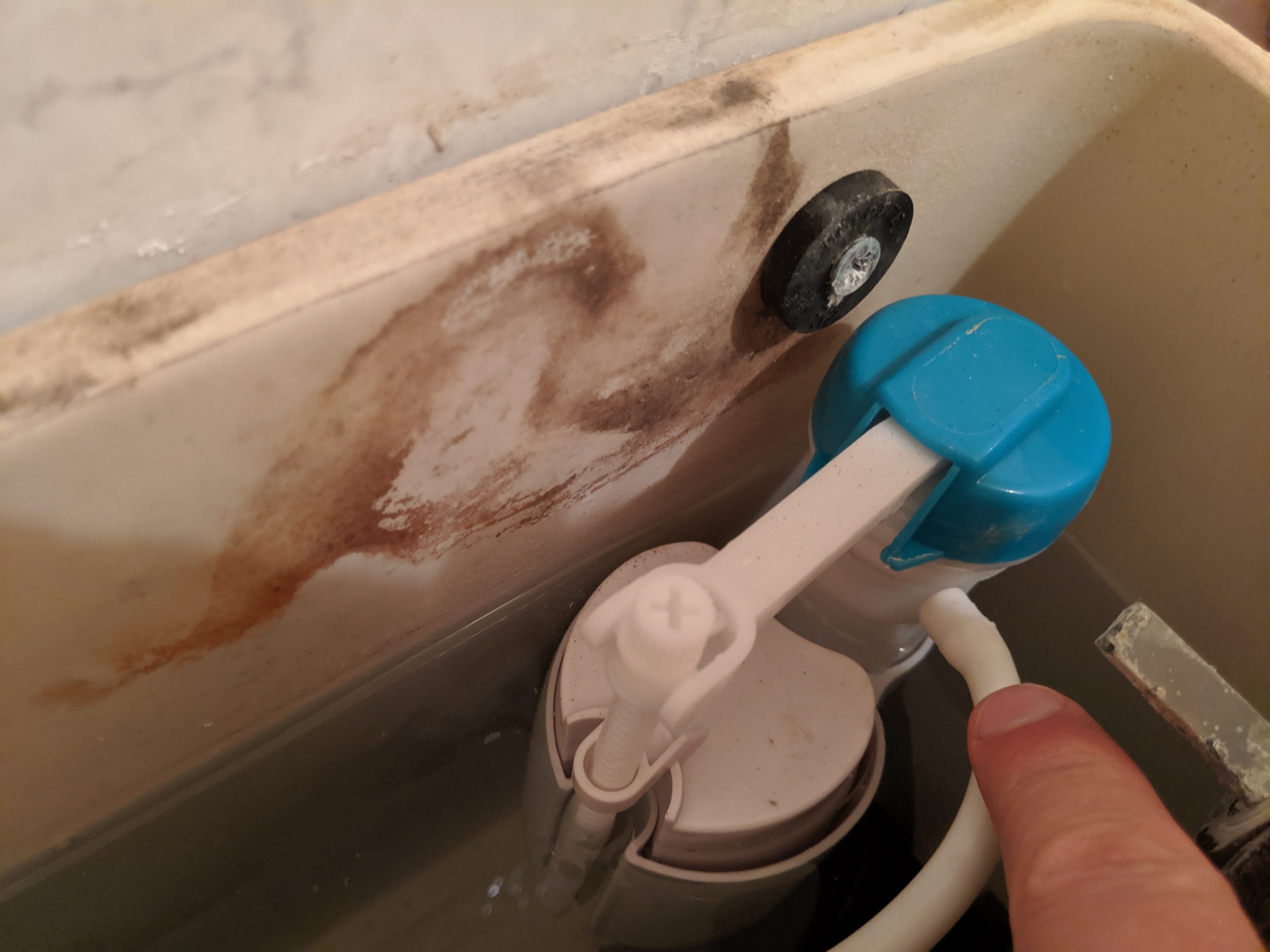

I installed a new toilet fill valve a few months back, it came with a plastic tube to connect to the tiny hole and I figured that's how it must fill. Looking at my other toilet after it had a problem, no water comes from the hole at the top at all and there's no plastic tube there. So I feel maybe this one is faulty somehow, even though it seem to do the job?? I'll attach a pic of the tube it's coming from. Fingers pointing at it. Thanks in advance.
They fill from the bottom of the stem of the valve, mainly to keep the noise of filling down as the outlet is underwater all of the time.
