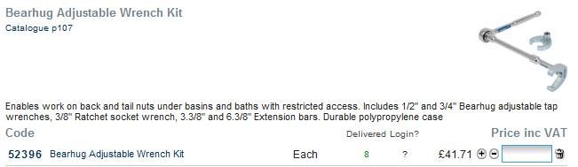

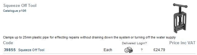

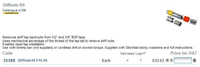

has anyone tried any of these thingamies.......
WT i'm not sure i would buy one of those pipe clamps. i'd be worried about weakening the wall of the pipe! having said that tho it is what they are designed for so perhaps they are ok.
the bearhug whatsit is probably good i been thinking of getting one myself since i've now broke a foot off of 2 crows foot basin/bath wrench's.
stiffnuts kit looks like it could be a lot of messing around. try adding heat to loosen, and if that don't work hacksaw the nut a bit and split it with a chisel, or if you like tinkering i'd sooner use a nut splitter set which is a posh way of doing the same!
