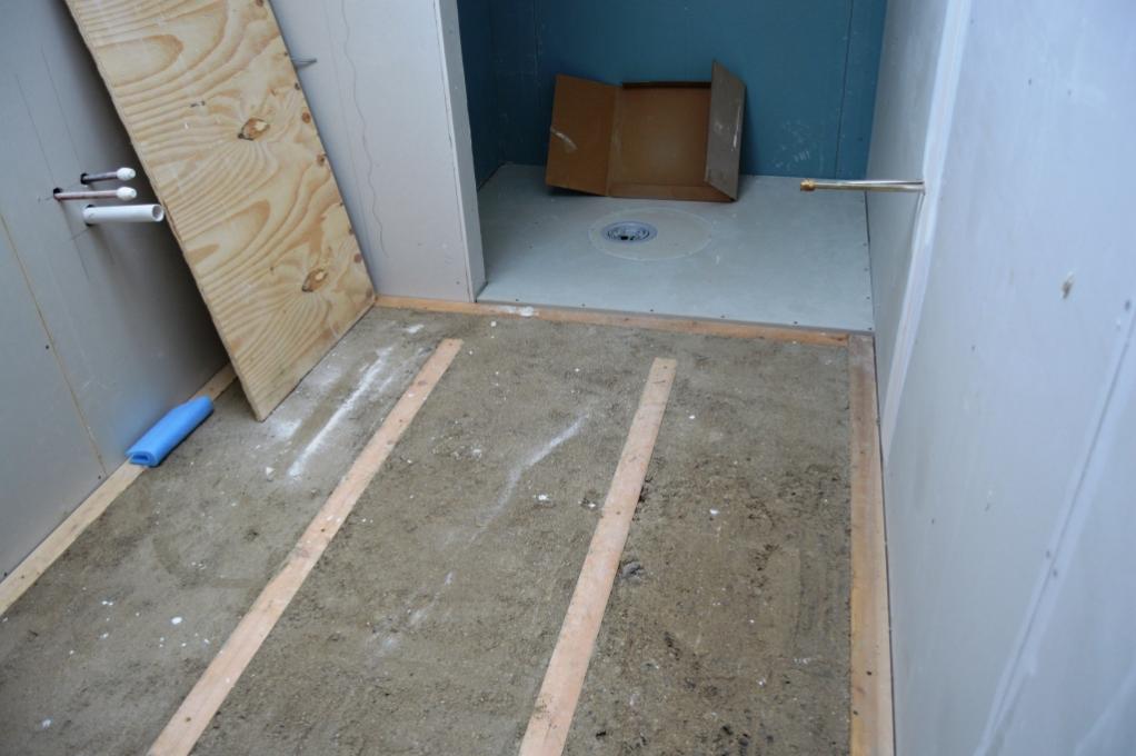

Doesn't matter if the screed cracks we use a 28mm pug screed cracking doesn't affect the thermal performance of the screed
we're talking 1st floor pug screed you wouldn't use 100mm upstairs, and yes it's great for tiling on :icon4:
200mm rockwool chipboard flooring then pipes clipped to flooring between battens, pugscreed then ply on top pug screed.jpg
