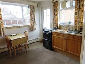

Hello, I went to view a Bungalow yesterday which we quite like, but it seems to have a weird heating system I haven't seen before. I presume it's all quite old, there was a floor standing Glow-worm gas boiler, and in each room along one wall, instead of radiators, there was just a low ( less than a foot ) metal sort of skirting board. Looking inside, it just looked like a copper pipe running through it, and that was it ??
I've had a look online, but it looks nothing like all the modern skirting board type systems, just wondered if anybody knew what it was, and is it straightforward to change the boiler and put radiators in each room instead.
Hopefully the attached picture will make more sense.

You have skirting convectors installed.
Nothing wrong with them, if they are sized correctly.
You can change the boiler and connect up to the existing heating system.
You get roughly 500w of heat per metre of convector, if that helps
Thanks for the info, so they are still fed by hot water being pumped around them, like a radiator system ?? Sorry for being thick, but I can't seem to find any info on the net. It doesn't seem to be very popular, so is it as efficient if they are sized correctly. Thanks again for your help.
Study the Energy Performance Report in the sales literature. This will cover insulation, heat loss and possibility of improvement. It should also give figures for a boiler upgrade. Doing the maths keeping the old boiler may be the best option.
These sort of heaters are often installed on a one pipe system which means if you were to convert into a standard two pipe flow and return there would be an additional cost of running another heating pipe to all the rads.

It may not be one pipe and could also have been be piped to separate flow and returns like modern systems. Don't let the single pipe construction fool you into thinking it has to be a one pipe system.
They are the old skirting radiators and must be very old. I haven't seen those for a long time.
Never liked them and always found a nice new standard radiator very much outperformed them.
Don't see the point of them ever been fitted in the first place when you have ample height for an ordinary rad.
The aluminium fins were just pushed tight over a single copper pipe running length of skirting heater. No way would that ever be much good as a heater. I always stripped the fins off the pipe so I had the scrap copper and so I know how poor they are. An ordinary steel convector radiator has a massive surface area for to lose its heat.
