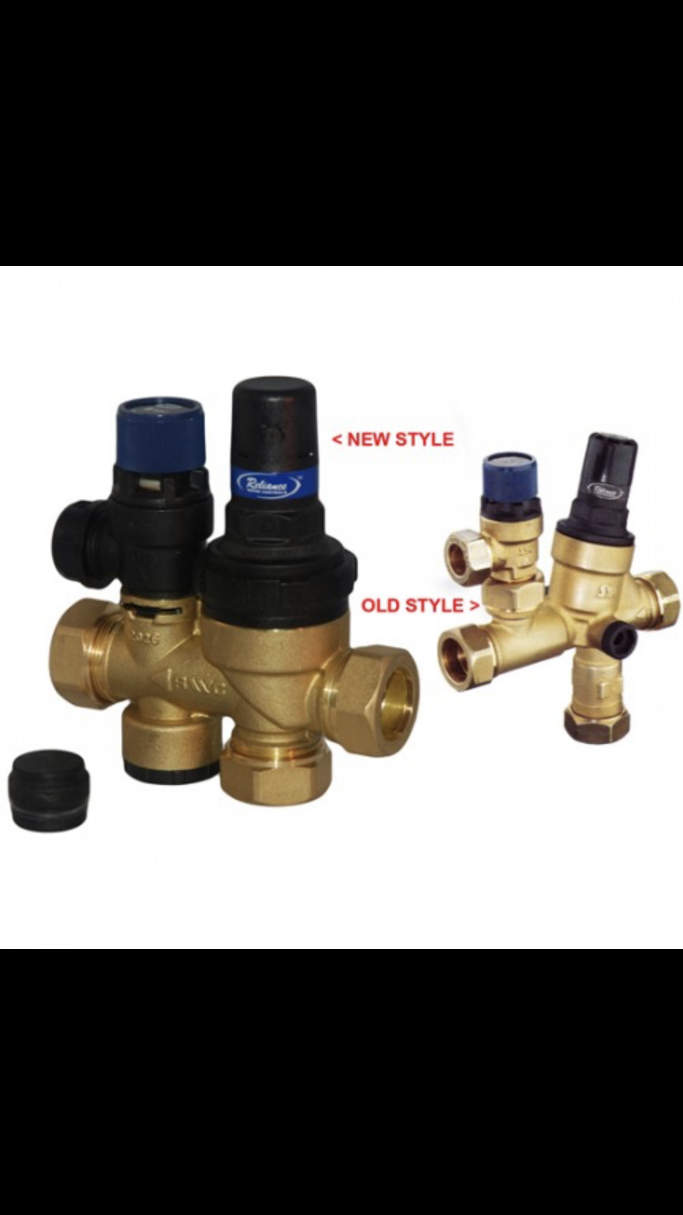

I must admit I'm overly cautious with the parts of systems I don't work/on install and so even if there is a valve (a lever on the combination valve I believe?) to isolate mains supply to unvented I have tended to just isolate incoming mains and run hot and cold taps to change them for fear of interferring with things I don't know about.
