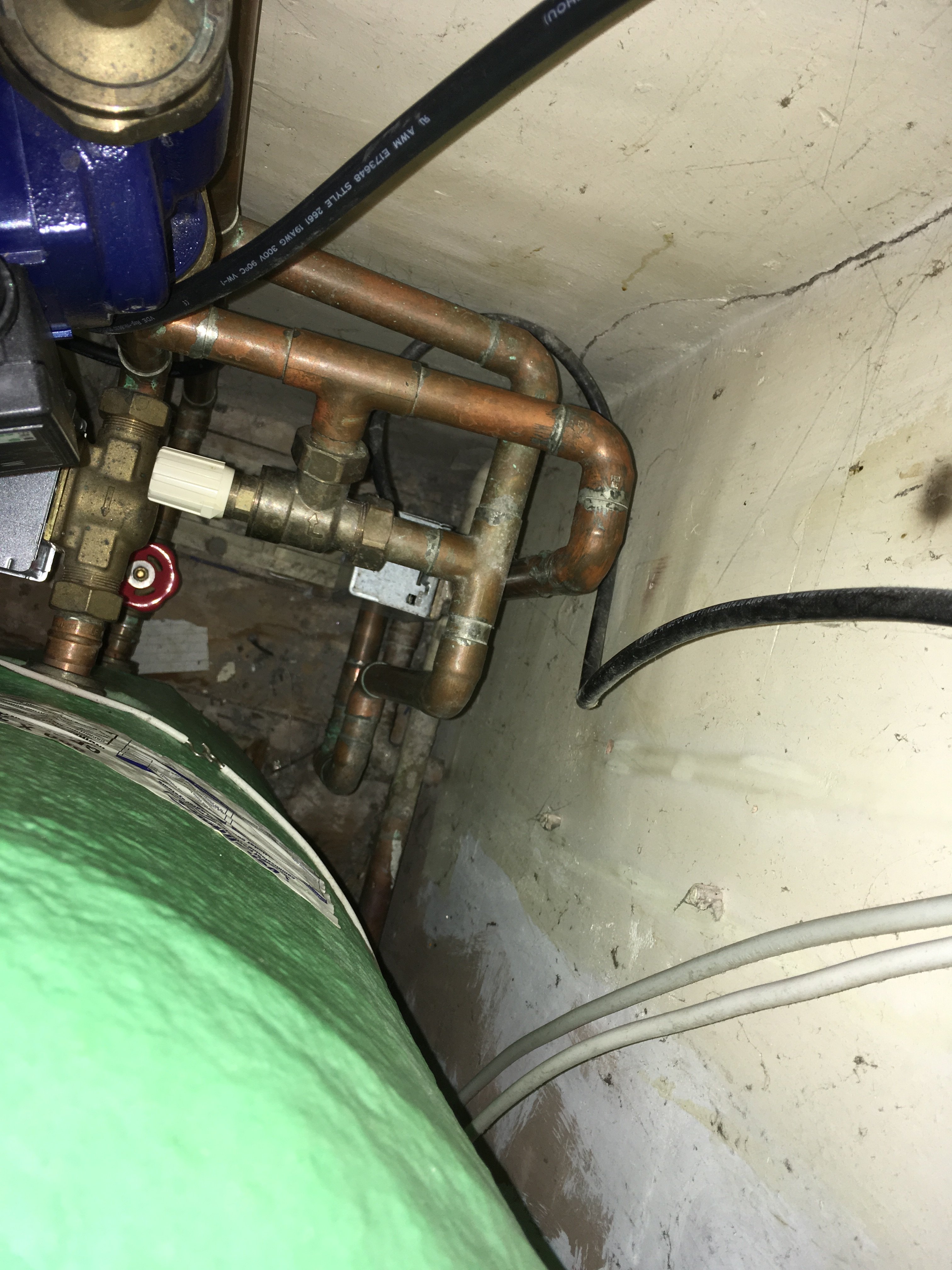

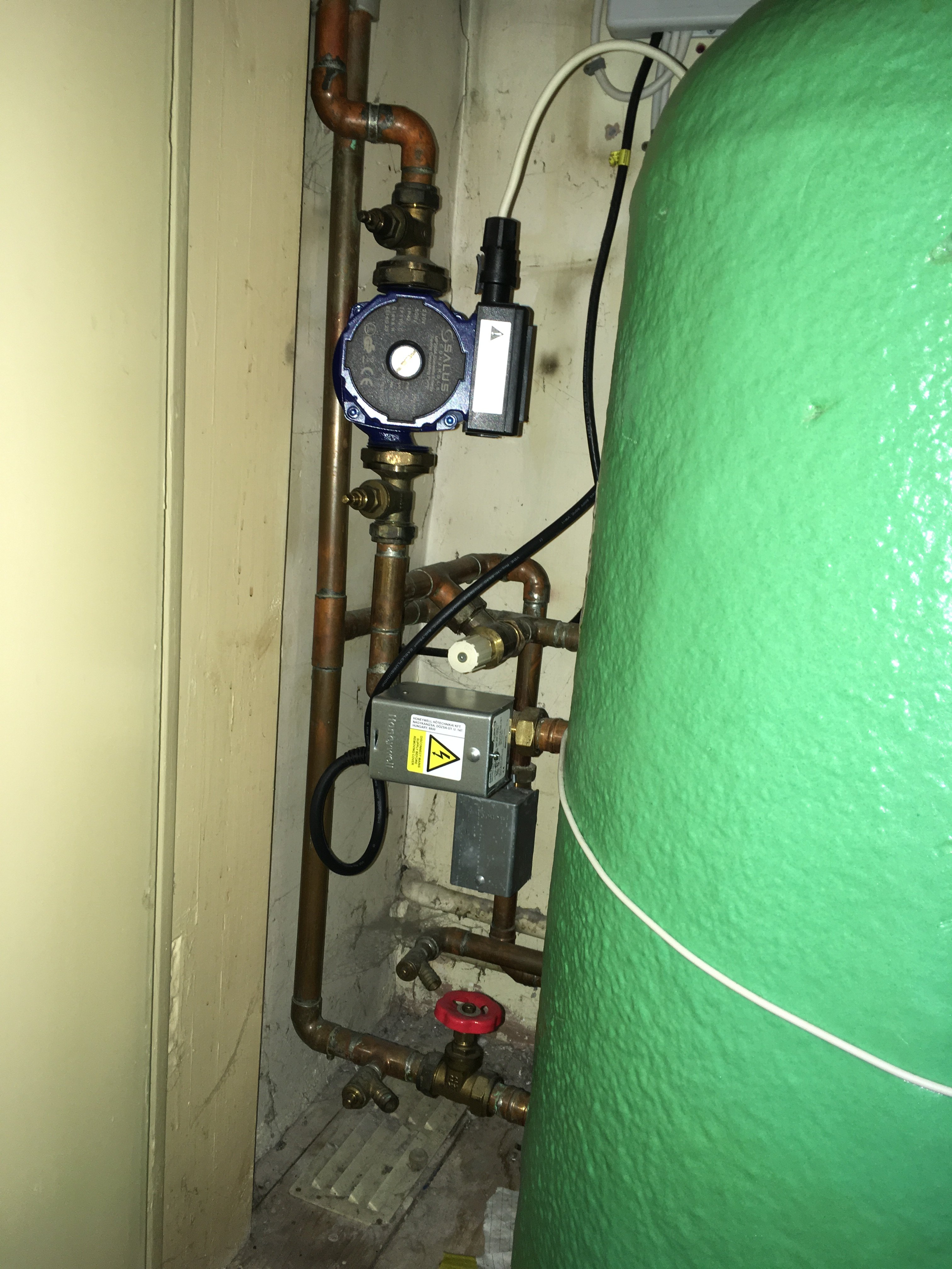

Right. I managed to get round there and have a look. I’ve tried to attach the photos but for some reason it won’t let me citing a security issue(?!).
Yes, there is a bypass valve, which was open, so I have closed it. The pump was also on the wrong setting for the type of system, so I have put it on the Auto setting. This does seem to have had an effect, as some of the rads are now getting warm.
However the boiler is still making a racket, as if there is an awful lot of air in there, or it is kettling.
It doesn’t spend so much time on S.53 any more, but it does seem to spend an awful lot of time on the over-run, and doesn’t seem to fire up for very long.

Is your cylinder downstairs with the boiker upstairs? If not it seams to be plumbed in upside down.
Also are there manual air vents in the airing cupboard? If so open them to get the air out. Also bleed all rads.

The boiler is in the cupboard with the water tank below (the tank can be seen to the right of the pipework in the photos).
Dan, what do you mean when you say it looks as if it’s been plumbed in upside-down?
There is a vent valve above the boiler, which had a very small amount of air in, and there is a valve attached to some pipes in the loft which had air in. I bled these but it has made little difference.
