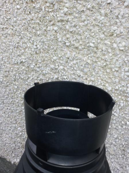

Quick question: I had a bloke out a few days ago to do a gas safety inspection, prior to me moving house. After leaving him to it, he came in to say the vertical flue had failed, because the top cap was missing. He said it had likely corroded, and gotten blown away, and that I would need a whole new terminal assessmbly. Fair enough, I thought, these things happen and the boiler is 10 years old. I asked if he could simply fit a new cap piece, but he said these were not available, and as it was galvanised, nothing else could be fashioned from an ABS cap, etc., to fit.
So here's the thing, I went up the ladders to have a look (boiler is in garage - flat roof). It's an Alpha boiler. The flue terminal top is ABS. How can ABS plastic corrode....?! It looks to me like the top disc has been twisted off, as the four little supports are twisted and snapped. There's no way this is corrosion. And I don't think a bird pecked it off!.
Anyway, lesson learned: but will I need to buy the whole terminal kit and get it fitted? The product code is 6.200075. It's around £95. As it is fitted onto a flue extension, I imagine it will just drop in, and so won't take too much labour time?

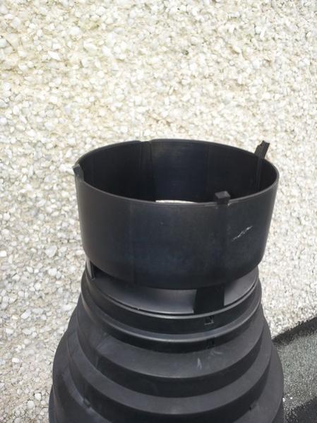

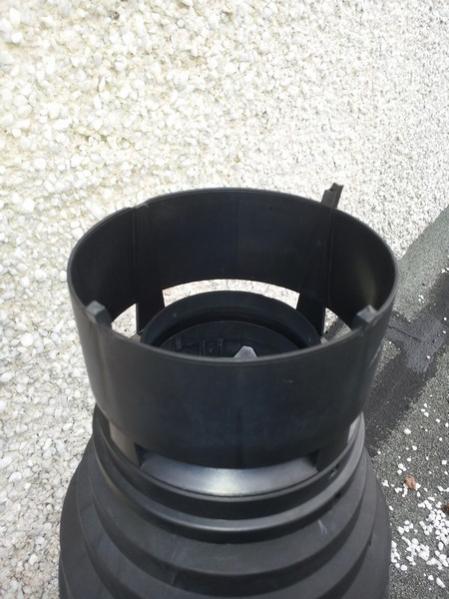

You can see that one of the support prongs has been ripped right off. Not sure how that could be considered "corrosion", as the fitter told me...
That's definitely broken but for the life of me I couldn't imagine a qualified gas engineer deliberately breaking that terminal.
I could be wrong of course but there are much easier ways to scam a customer if one is so inclined.
It looks to close to the wall to me, whats the distance between the flue and the wall?
Could be camera angle though.

More than likely the guy just looked at it from the ground or standing on something and never actually wet on the roof. Many vertical flues are made of metal. He just reported what he saw. The top is off it.
Btw that flue section will not be a lift out drop in swap. For starters it is too close to the wall. It will need moved. (we don't make the rules)
It looks like it has been felted in with the roof so the felt will need cut as it is stuck to the flue, the roof patched and a new flashing piece put it.
2 - 3 hrs work.
