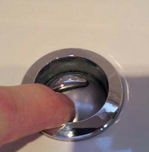

The push button should screw of, when that is of you can just lift the lid of, you may need a new ball valve as I suspect the water level is getting to high and is going through the overflow and will cause the water constantly running into the pan
yes the push button in the picture it should just screw of if not, you need to prise the buttons out of the ring and there will be a screw under it, try just screwing it of first though
Got the lid off....thanks Mr M.

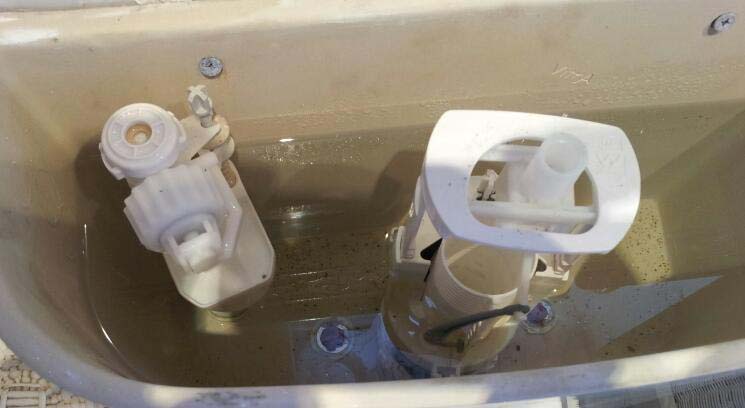

The noise I've been hearing is like a release of bubbles, it happens now when I push the float to the left of this photo.
The water level never seems to reach the overflow tube on the right?
Have you tried adjusting the height of the float to lower the water level in the cistern?
The white plastic rod with a cross on the end - turn it (closkwise I think) to adjust the height of the float about a centimeter lower than it is now. If that doesn't fix it, then yes, replace with a quality brand like fluidmaster.
I thought you meant there was a seperate overflow out of picture on the right. If you mean it is passing without reaching either a seperate overflow - or the integral overflow in the flush valve then 'oops'...
No mate, the tube in the original picture I presume is the overflow into the bowl?
Yep that's it. and it must be kaput as mentioned previously. Looks relatively clean in your cistern but who knows, it may need just cleaning or replacing as mentioned above.

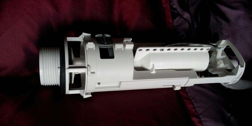

I took the old unit out & cleaned all the seals first then re-installed it.........no fix!!
Bought new unit, set up identical to old unit & still the trickle!!!
Must be a problem around the outlet hole, will try plumbers gold as suggested, then maybe a hammer ;-)
Without being there it's really difficult to diagnose.
Given what you have said about the cistern totally emptying after flushing it must either be the top seal on the flush connection or the bottom seal in the flush mechanism. You could easily diagnose which if you take the cistern off but leave the flush mechanism in place then put it over your bath and pour some water in it. Look from below to see where the water is passing. If it's dribbling down the threaded part then it's the seal between the valve and the cistern base, if it's dribbling down the inside of the pipe then it's the mechanism.
If it turns out to be the mechanism then take it back to the shop for a refund and get down to a screwfix for a fluidmaster button operated syphon - that is of course if a fluidmaster will fit in there, best to measure first...
