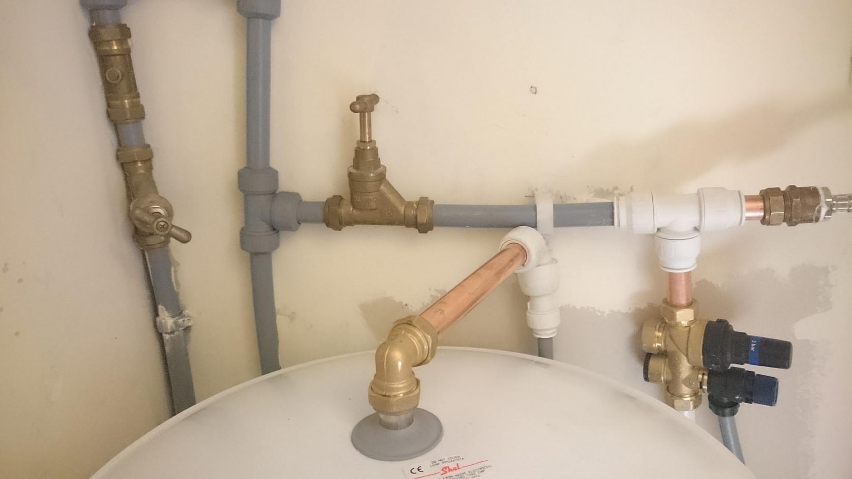

I had a direct unvented cylinder installed at the end of last week by a well reviewed plumber on myBuilder.com. He claimed that he was fully qualified to install unvented cylinders, albeit most of his reviews were from gas work. I was away on business at the end of the week, and my wife was on hand to let him complete the install. Some alarm bells went off when I saw the completed install.

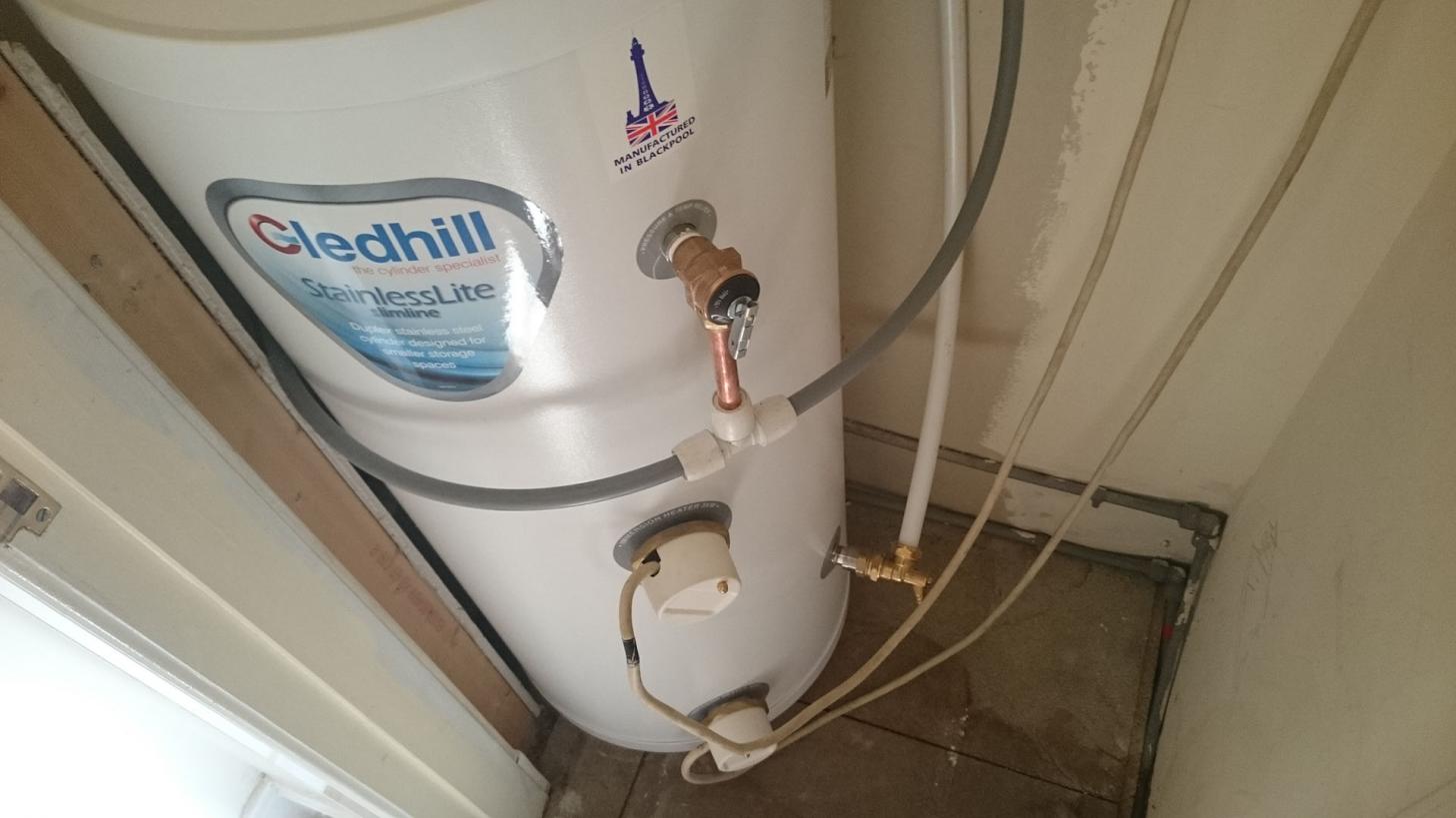

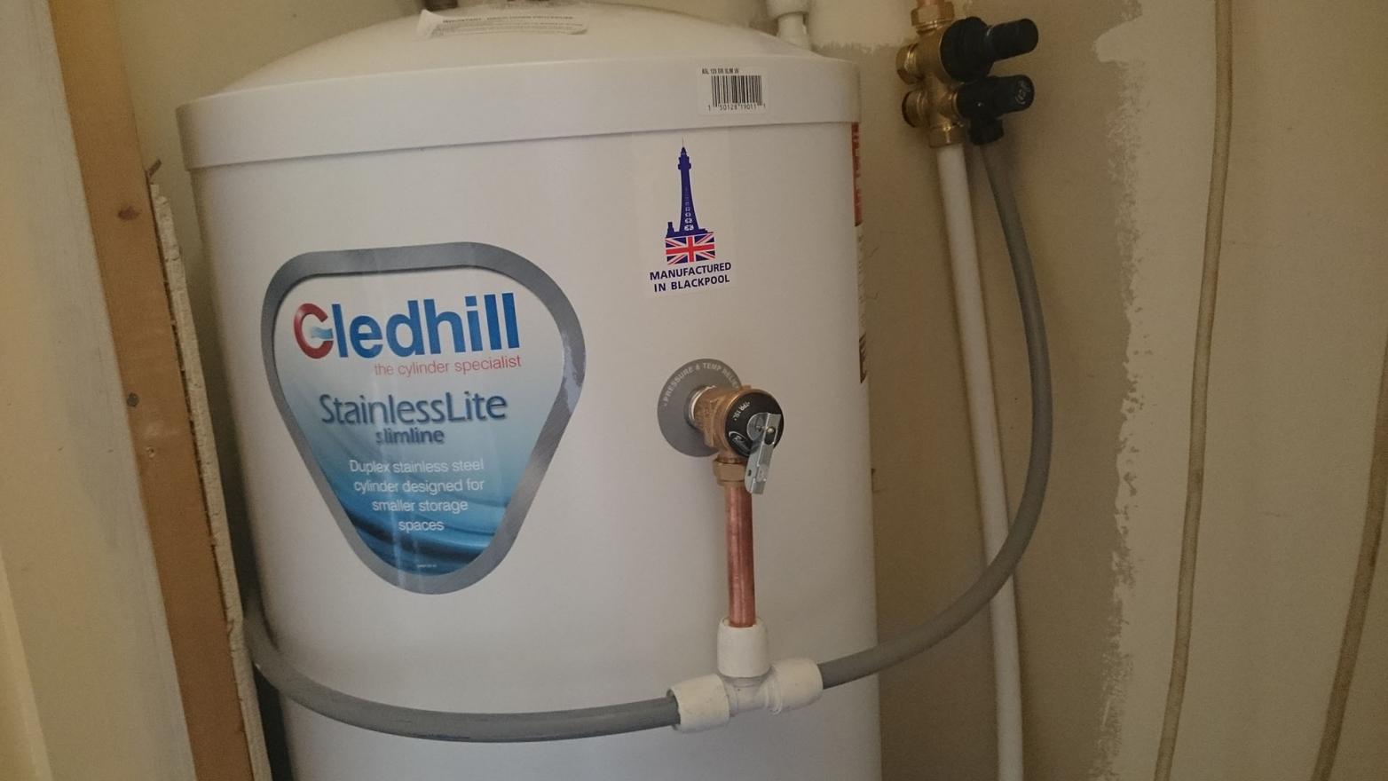

The first glaring issue, is that the tundish was not installed. I supplied the cylinder myself, so I know it was supplied with one. I queried him on this matter after the install had been completed, and he claimed that it wasn't needed as the communal discharge pipe it leads into serves essentially the same purpose as the tundish would have.

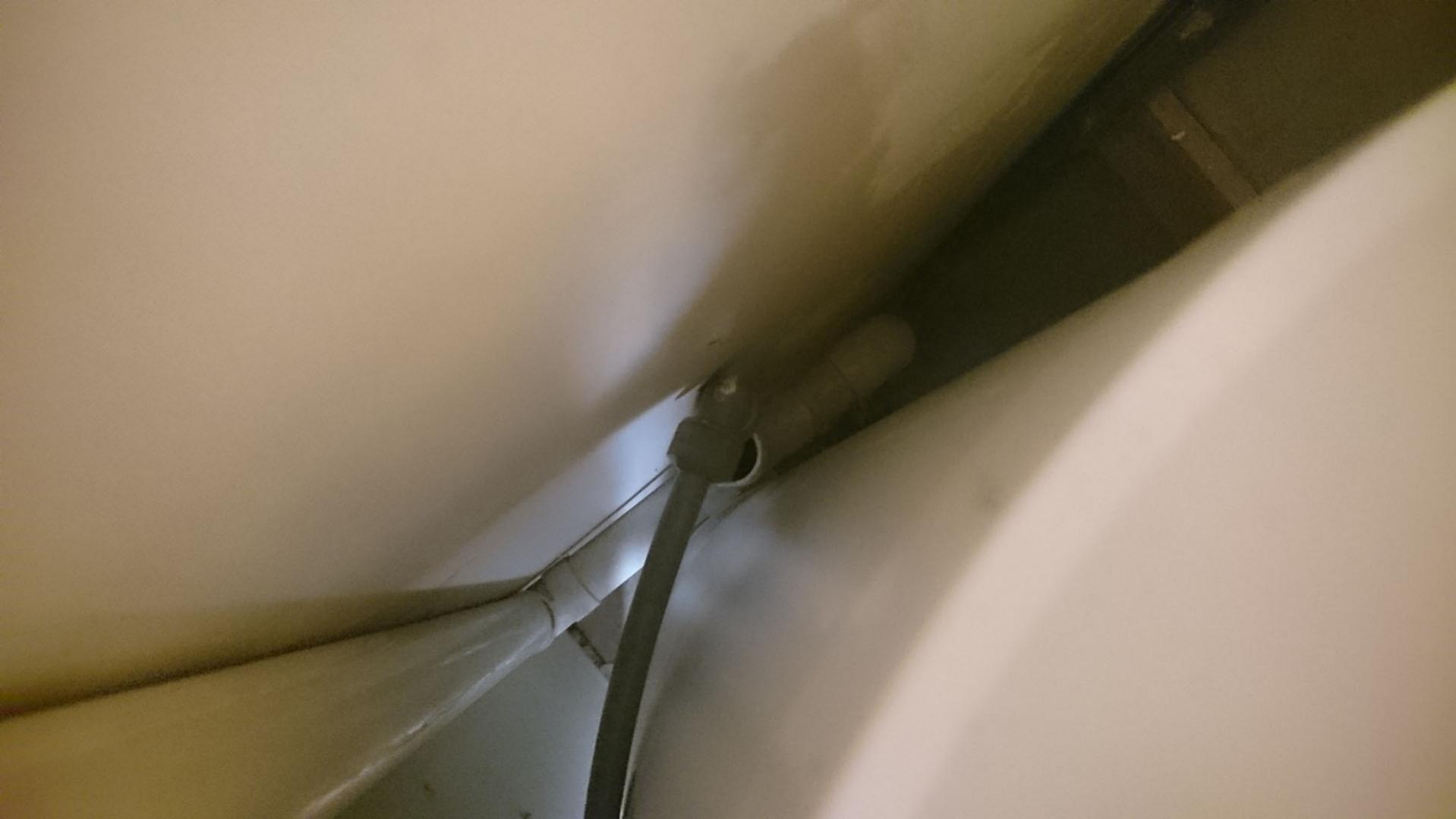

He also didn't complete the installer information certificate on the side of the cylinder; the certificate is actually totally blocked by the positioning of the tank, as it is 90% hidden behind the wall.
Are there any other issues that you can spot with this install? Is the use of plastic piping acceptable in the manner he has used it? How about the other components he used? Any other advice?
I would appreciate any insight from those familiar with how unvented cylinders actually should be installed.

That plastic pipe shouldn't be used for the safety discharge pipework, it's not capable of withstanding the high temperatures that the discharge could reach. Definitely not an install by someone that knows what they are doing.

The expansion vessel's doing absolutely nothing the way it's fitted !
It should be connected between the expansion valve (where ther is a non return valve ) and the cylinder, not upstream of the pressure reducing valve.

As already stated the expansion vessel is doing nothing at all where it's installed as it's upstream of the control set and any expansion won't reach the vessel and we know where that could lead. With the quality of work shown in these pictures I wouldn't be surprised if the immersions are on to the highest setting.
The discharge pipework also fails to meet the requirements of the G3 regs insofar as there is no tundish meaning the pipe size hasn't been increased and it also discharges into ABS pipe which isn't acceptable. Could the discharge be seen if the TRV or PRV discharged?

Needs to be switched off! Judging by that install i can't quite tell from the photos but we can't see if he has used immersion grade flex linking the immersion elements and the fused spurs. You could be looking at a potential fire hazard. Switch off the cold water supply to the cylinder and open a hot tap to take the pressure out of the cylinder and switch off the immersion heaters. Get a qualified installer to start from fresh with it.

The tundish must be fitted & within a certain distance from t&p discharge valve. He hasn't a leg to stand on with that work.
