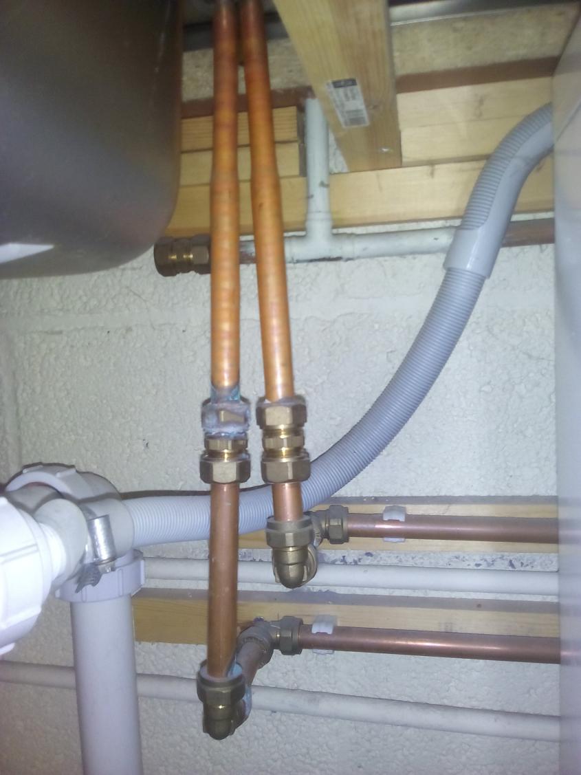

I removed the washing machine filter to check for blockages and clean it but all the water that was in my kitchen sink started coming out of the washing machine filter hole. So rather than going out the waste pipe it's going out the side nozzle through the grey tube then seemingly into my washing machine. Here's a photo of it: tiikoni.com/tis/view/?id=3dfbd15
Does this look wired properly to you? Any help with what to do would be much appreciated!

steveb I've twisted the nozzle the tube is connected to upwards. Is that what you meant?
So when washing machine water comes into my sink and the kitchen sink water comes out of the I've just twisted upwards, those are both due to a blockage?

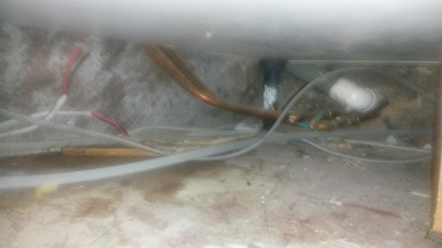

I've never looked under the cabinet properly before. It's quite a mess, does it look ok/safe?

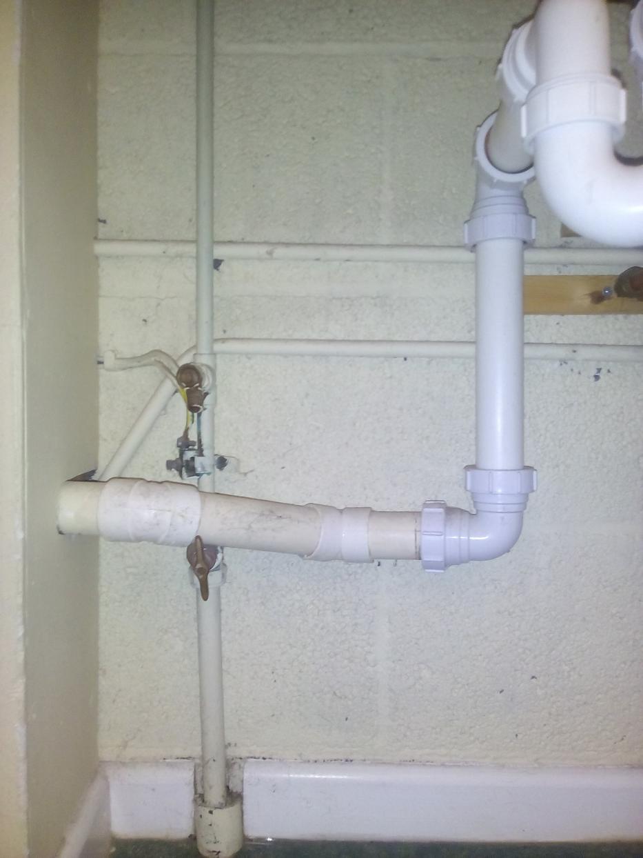

The washing machine waste should look more like this.
But the waste should not look like this.
