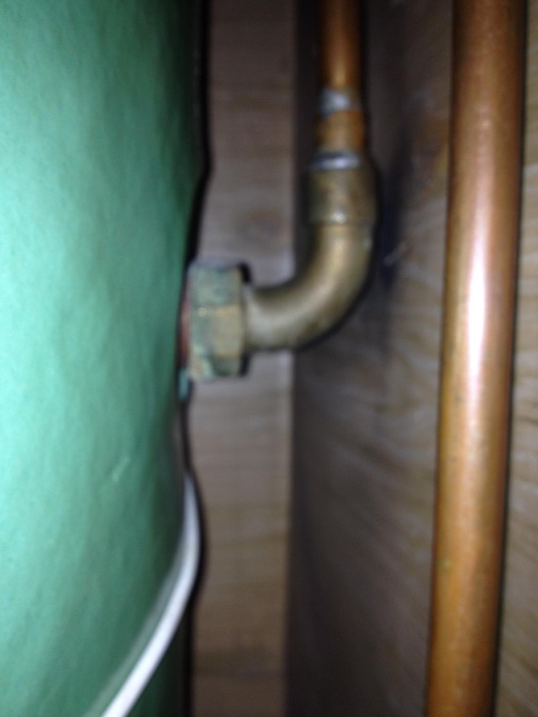

i have had a similar problem once before on a heating circuit. The radiators stopped almost overnight. I checked everything and in the end chucked some sentinel x800 jetflo in and within 2 hrs they were working again. Still never found out what caused it and the water was gin clear.
before doing this though, I would isolate a pump valve and carefully crack the nut in the picture with a bin bag underneath to catch the water, this will push water through the bottom of the coil and out the top just to check for blockage or air, the coil could be bend and rising up trapping air although unlikely. Make sure you open the pump valve again.
That's another good suggestion mate and I can do that quite easily, as a non professional, as long as the missus can hold a bin bag 😉.
