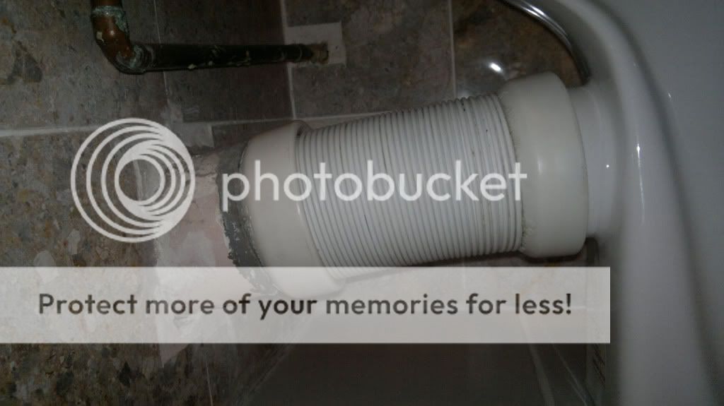

I'm trying to install a toilet but the waste pipe and outlet from the pan are misaligned. I therefore think I need a flexible connector, but all the ones I can find are too long.... the gap between WC and waste pipe is 135mm and the shortest connectors I can find are 150mm. Does anyone know where I could buy a shorter one, or how else I could connect the WC and waste pipes?
Sounds like a straight multikwik extension and a offset pan connector would do.
Post a pic of it...:hair:

Here you go:
Thanks a lot for all your replies. 🙂 Tried to post a picture last night and again this morning, but the moderator wouldn't allow it for some reason!?!
Problem solved now, found an ultra-short flexible connector in B&Q of all places, so the toilet's now installed. Again, thanks a lot for all your help!
