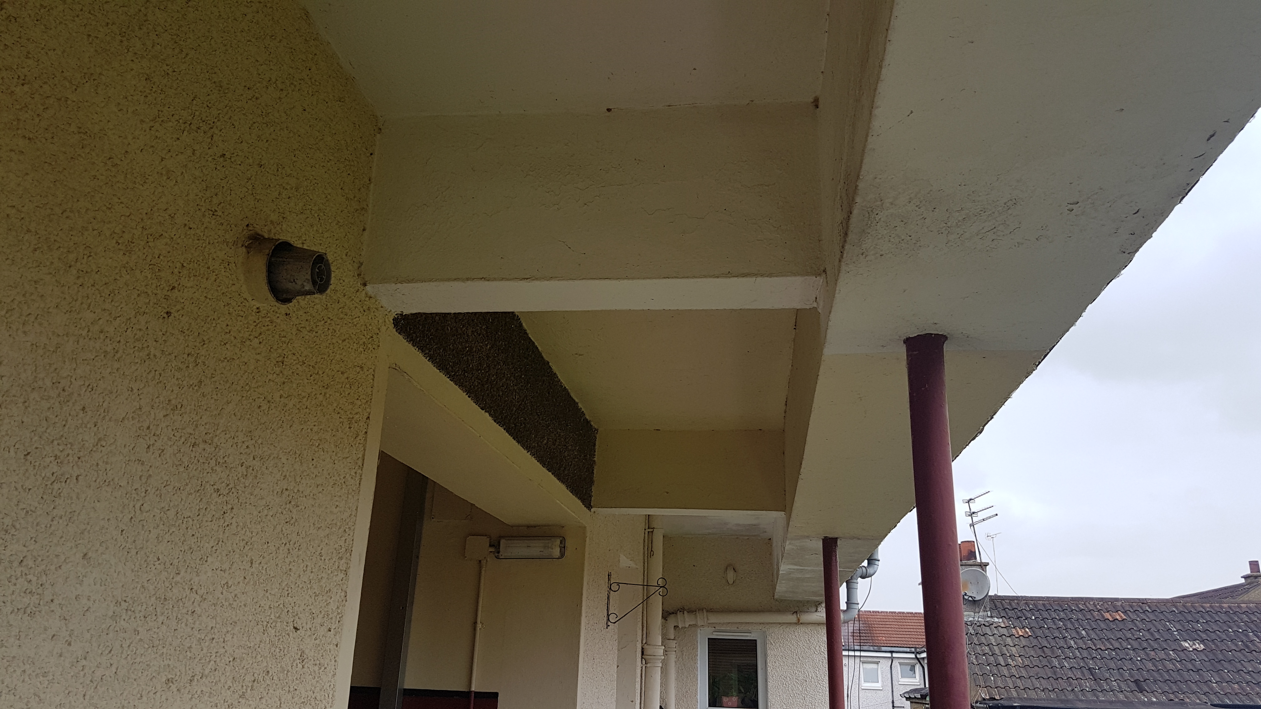

Hiya, just been and done a survey for a combi swap and came across this. It's a 4th storey flat, modern condenser going in obviously, customer is aware of the plume and is fine with it. I suggested running the flue along and out the canopy but the customer isn't happy with this. I'm quoting against a company that has offered to crawl out the customers skylight and go over the ridge to the other side of the roof, 4 floors up to install a vertical terminal. Customer isn't too keen on them doing that either as you can imagine. What are your thoughts on putting a standard flue there?
