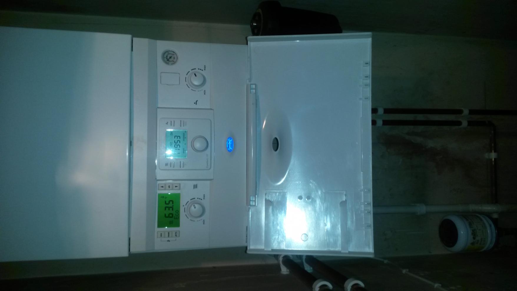

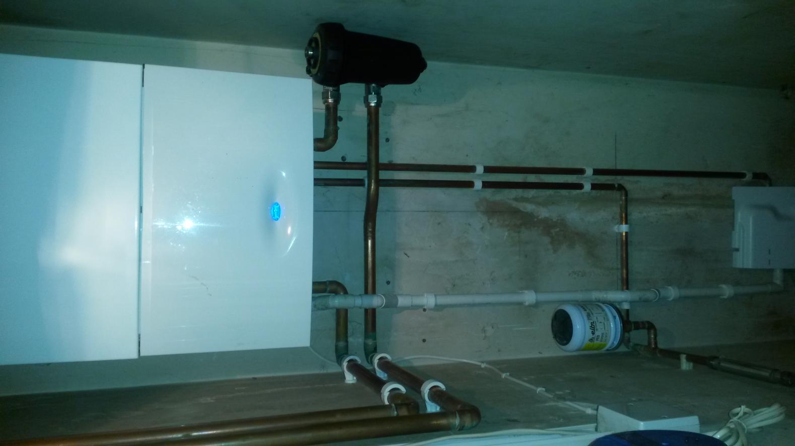

View attachment 28834View attachment 28835
the rad valves arnt the type with two pipes going into one valve is it ?
if yes get them replaced should be much better
also with combis you need to rate them on hot water not heating so your fine there, but as we have said need to be down rated
As mentioned previously get an engineer to run a heavy duty cleaner in the system for a week or two and then clean each rad out individually replacing each thermostat (TRV) while the rads are off (do not opt for another power flush unless they have specific experience of doing so). That really should improve circulation or bite the bullet and replace the microbore.
All looks tidy there bud a picture of the loft may help is the system vented in the loft ? It may just be air locked the boiler can modulate down to 7 - 8 kw on heating side so providing you have flow it should work ok , did the engineer have a look in the filter that would be a tell tale sign of how bad your system is .

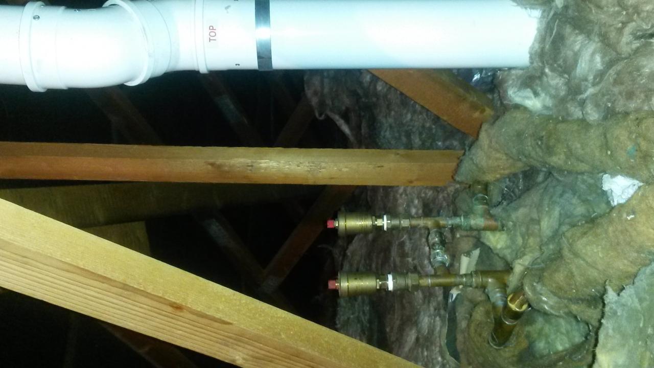

Adding pic of the bypass pipework in loft. The engineer was going to switch off the bypass to prove his point, but when he tried it started to leak so he didn't want to continue. But he was convinced that was the problem. He didn't bother looking at the filter as kop asked, as he said that that catches rubbish just before the return to the boiler, and it was his opinion that the blockage(s) were in the hot water loop itself.

There's your problem bud that bypass valve should be sprung loaded type not a normal 15mm isolating valve a honeywell or similar the water is finding the easiest route up through better to move the bypass below the ceiling and make sure your flue fittings are drilled and screwed together and also get your engineer to clean the filter have a look at it to see how much magnatite is stuck to it . Regards k
So, I've been looking at info re the spring-loaded bypass valve, and it seems like that is definitely the way forward these days. But again, the one in place is left over from the original CH install about 15 yrs ago, when I from what I've read it was normal to have a valve like I have partially open.
