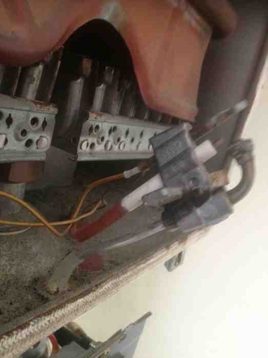

Had a look at a gas fired water heater today, pilot would not light. I removed pilot assembly from the supply tube, depressed control knob, there was plenty of gas there.
From this I gathered that the pilot injector was blocked. I tried to clean the injector, to no avail, so for now, water heater is out of action.
I was going to order a new part, before I do though, I wanted to ask on here can these be cleaned out usually?
Also, the bottom nut on the pilot assy. Which connects to the supply pipe from the gas valve is sooted up, around and above it. Is this a tiny leak which has ignited previously?
I tightness tested everything before I left and sprayed joints after the gas valve with LDF, and isolated the appliance until the problem is rectified.
