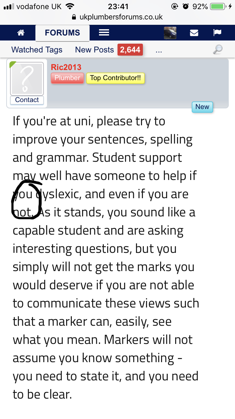

If you're at uni, please try to improve your sentences, spelling and grammar. Student support may well have someone to help if you aredyslexic, and even if you are not. As it stands, you sound like a capable student and are asking interesting questions, but you simply will not get the marks you would deserve if you are not able to communicate these views such that a marker can, easily, see what you mean. Markers will not assume you know something - you need to state it, and you need to be clear.

You will note I have not edited my original post since your reply. It does not read as you have quoted it. When I view it on my screen, I see the words 'if you aredyslexic'[sic.] . You are correct to note I have missed a space, for which I can only apologise, but that's not so bad as to miss a whole word. Are you deliberately mis-quoting me, or is there a technical imp at work?
No mate. In the picture That I took of your post. You can clearly see that it says you and not you are. That is what I was pointing out.
Not to worry. I just found it funny that you had made a mistake after taking the p out of the OP. :p:p:p:D
I wasn't taking the Sod. My point was that a lot of people who work in unis are lazy sods and probably couldn't be arsed to make the point I was making, and so I made it because it was better he hear it from me and be offended than not hear it at all and fail, especially if he is otherwise a good student. If there are extra services available, then it's worth making the most of... how much a year now?
