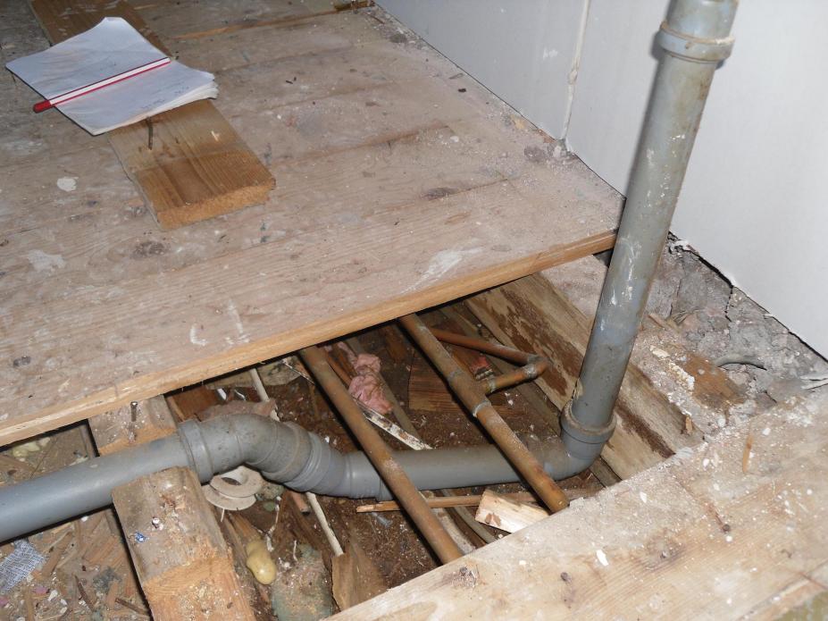

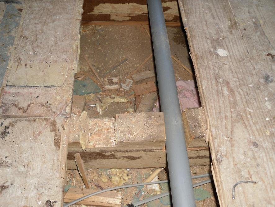

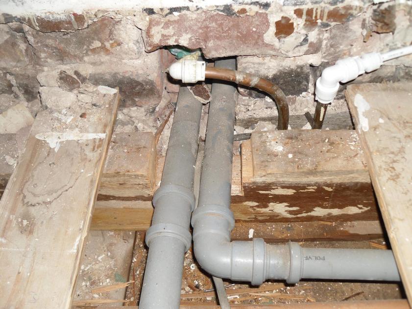

im currently working on a house - a lot of plumbing, kitchen and bathroom. now the bathroom ive lifted the floor boards today to have a look at the wastes and the 1" and a quarter and inch and a half from the basin and shower respectively are notched into joists trhough every single one... so there is 2 2" notches 4 inches apart from each other in each joist going through bathroom - also the waste for shower, is notched half way down joist as the previous shower tray sat straight onto joists and landed half on half off a joist....
also basin waste went along joists and 45 down and back up under 2 15 mm heating pipes and continued on its run 😡

5 1/2" by 2" and they span 3.8 metres support wall to support wall they have got a wooden beam support about one metre in from supporting wall. we are hoping we can put another small steel support bean same sort of difference from other wall under joists and go about it that way - the building control officer if thats what you call him is getting back to me next week but i can see this being a site engineer visit to be honest.
take it its down stairs you can notch 1 3rd of a joist this would not bother me am a carpenter by trade and as i said before i would ply the side of the joist for some extra strength then 1" ply the floor makeing the floor a complete slab you would have a job on ur hands to get a steel plate/beam under thier to do and good as would have to be i one piece and bear 150mm on to the bearers either side
no mate its upstairs. above a dining room
and you cant notch a third of joist its against regs whether or not it would bother you is a different matter no offence intended its building regs me and my company work towards - your allowed 1/8th. but thanks for your advice on a solution i will wait until building control get back to me on this one - the support beam underneath i would think would be a better solution as your not adding weight to weakened joists.
i've seen worse! i couldn't believe it, but notches at least 3/4 of the joist depth! waiting to hear from customer about what she wants to do.

that shower notch is bad, looks like they've used expanding foam to sort of stick one side of the joist back. classy.
at least you dont have to buy a trap for the basin
