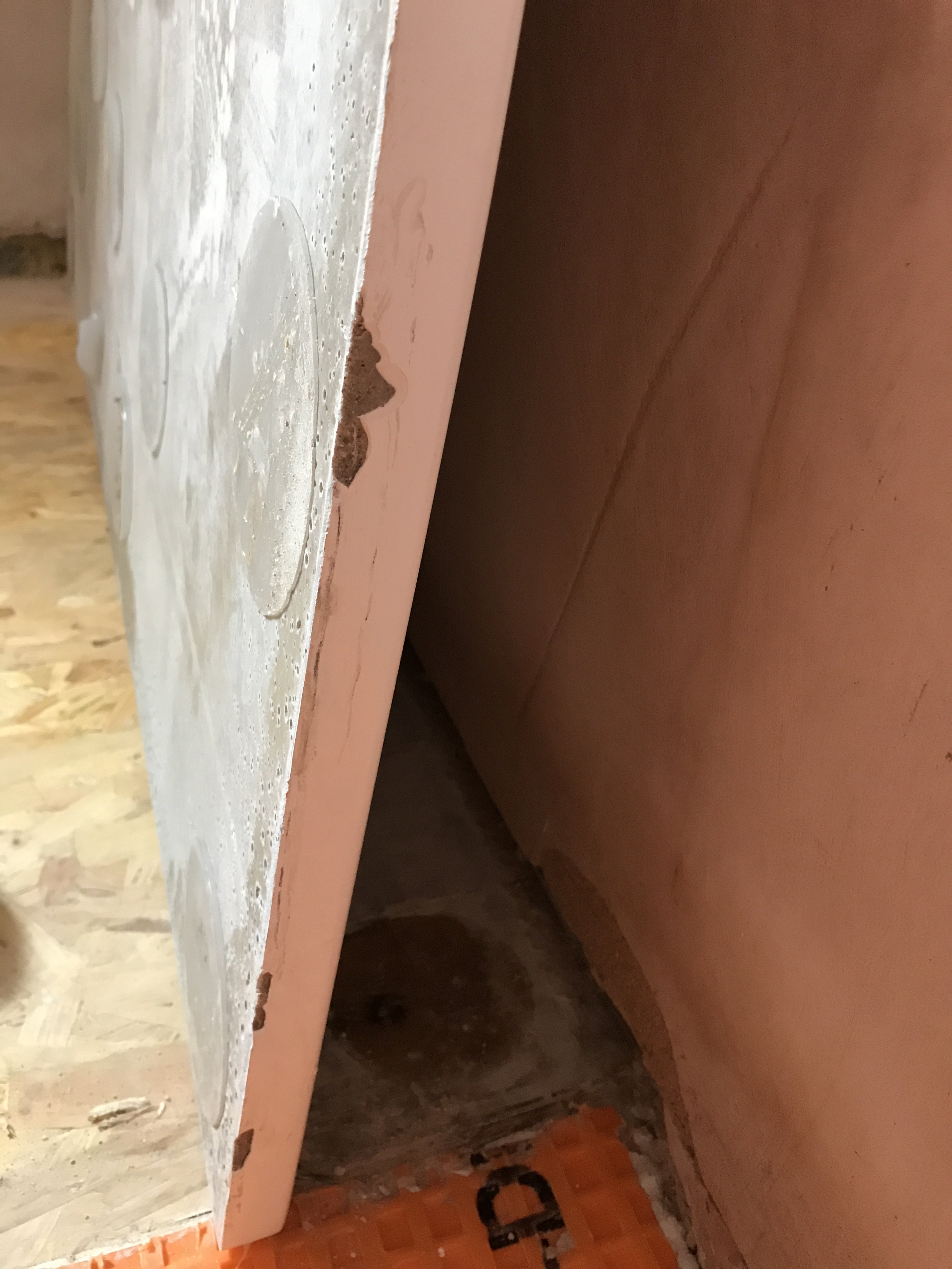

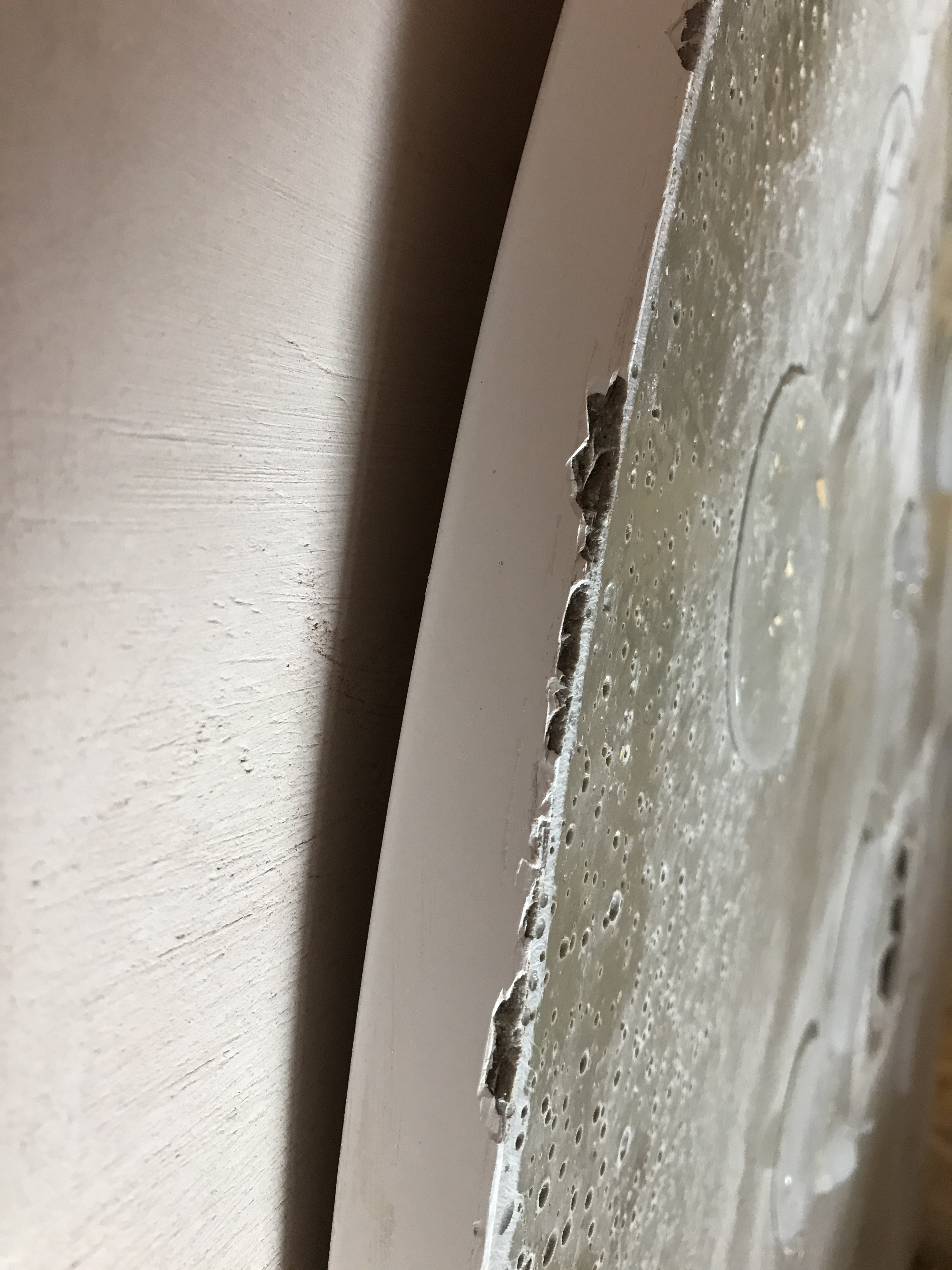

OK, quick update. I popped down to Screwfix this morning and bought a pry bar and have spent the last couple of hours nervously cutting away small sections of the OSB around the shower tray with a multi-tool to allow me to get the pry bar under it. I also had to chip away the plaster where it came right down to the tray. Then I went round the tray and gently applied pressure at various points. It was quite nerve-wracking but the good news is I managed to get the tray up in one piece! (Before anyone jumps down my throat, I explained in an earlier post why I decided to do this myself rather than leave it to the new plumber).
The pry bar caused the edge of the tray to chip in a few places, but hopefully the tiles will hide these.

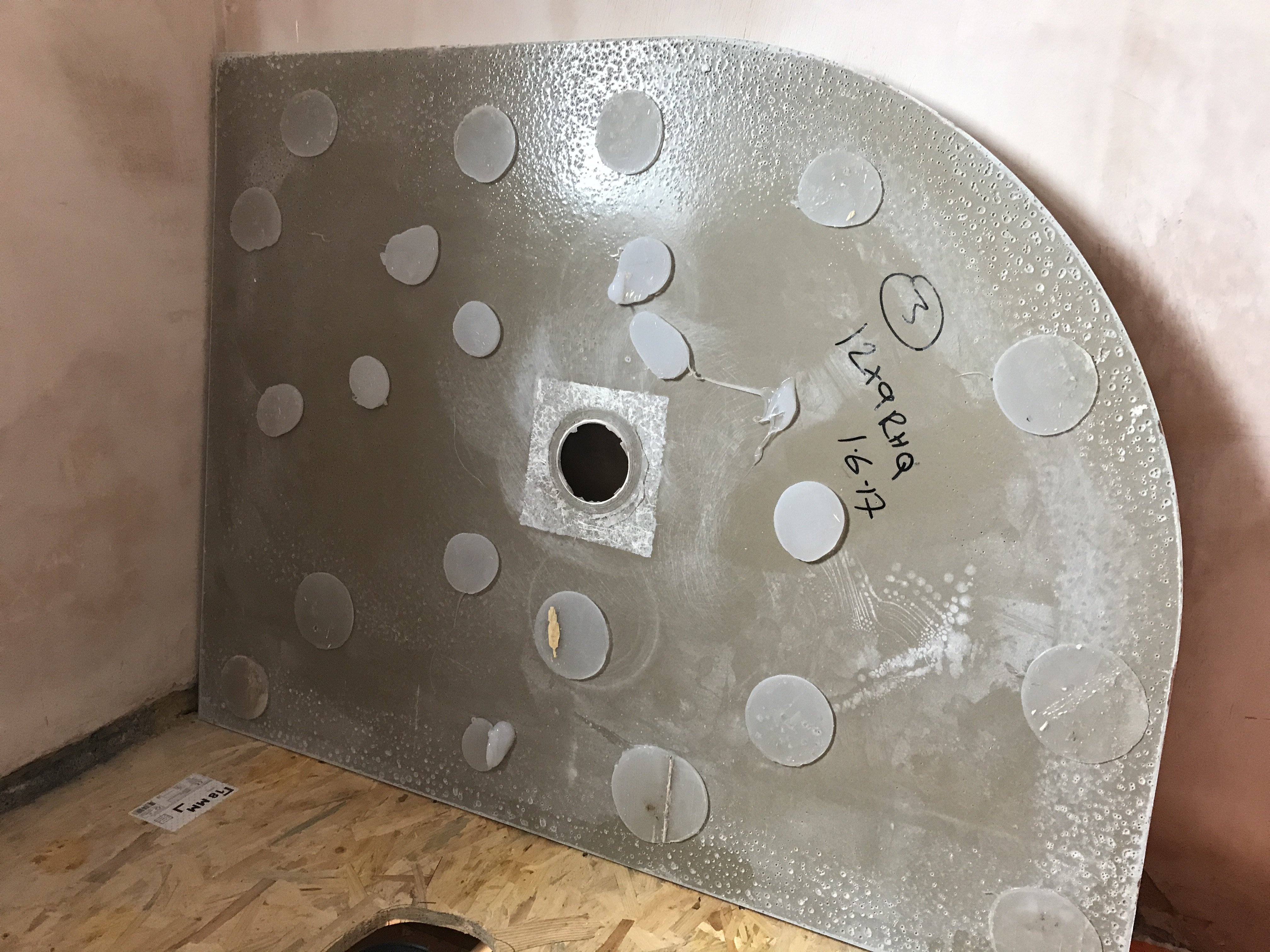

As you can see from the attached photos, our cowboy "plumber" used a few blobs of silicone, so the tray wasn't bedded down on anything! He also cut out a massive hole for the waste, so the tray was completely unsupported over that area.
I'm now planning to take up that section of flooring and put down a new piece of marine ply or OSB, clean all the silicone off the tray and let the new plumbers install it properly.
Any tips for getting the silicone off the base of the tray? Presumably it doesn't matter if there is some residue on the tray, as the sand & cement (or tile adhesive) will level things out?

What a clown , didnt even figure of six the silicone ,
The tiles and silicone finishing seal will cover them chips around the tray ,
All in all id say your good to go , bit of ply and a nice neatish hole for the waste ,
Id def spend a tenner on some ct1 or sticks like , for running round the underside of the waste to tray seal , it also helps it stop moving (depending on the waste finish) if people stand on the waste when showering , if you know what i mean ,.
Well worth doing , you will sleep easy knowing its all done correctly ,
How did it lift once you got underneath it ? Doesn't look like it stuck
I sort of gently prised it up a few millimetres at a few points around the tray, then gradually built up the courage to apply a little more pressure. Eventually, on one attempt, I heard the sound of some of the silicone slowly tearing away from the flooring, so I went round the tray trying to repeat this at various points.
I also went along the two straight edges with a multitool to cut through the bead of silicone holding it to the wall as well as I could.
As the tray came up a few more millimetres I placed some magazines below the tray at several points to hold it up. This meant I could get the pry bar a little further under the tray to stop it slipping and chipping the edge of the tray.
When I was able to lift the tray a couple of centimetres, it started to hit the plaster that was overhanging the straight edges of the tray, so I used the pry bar on its side between the wall and the side of the tray to gently pull it away from the wall. This helped break the silicone holding the tray to the wall, and probably also helped with the few remaining blobs on the floor which were still holding on tight.

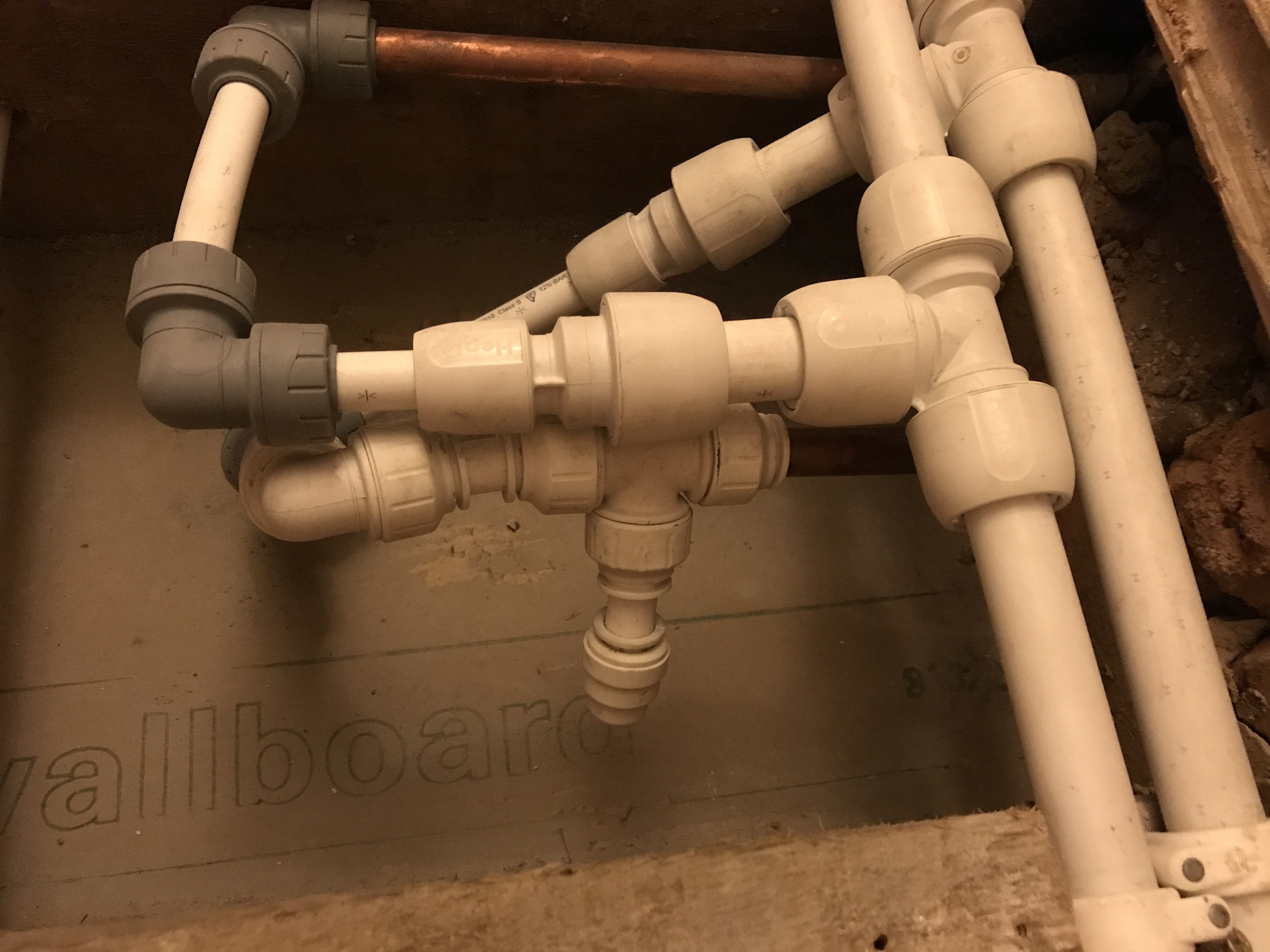

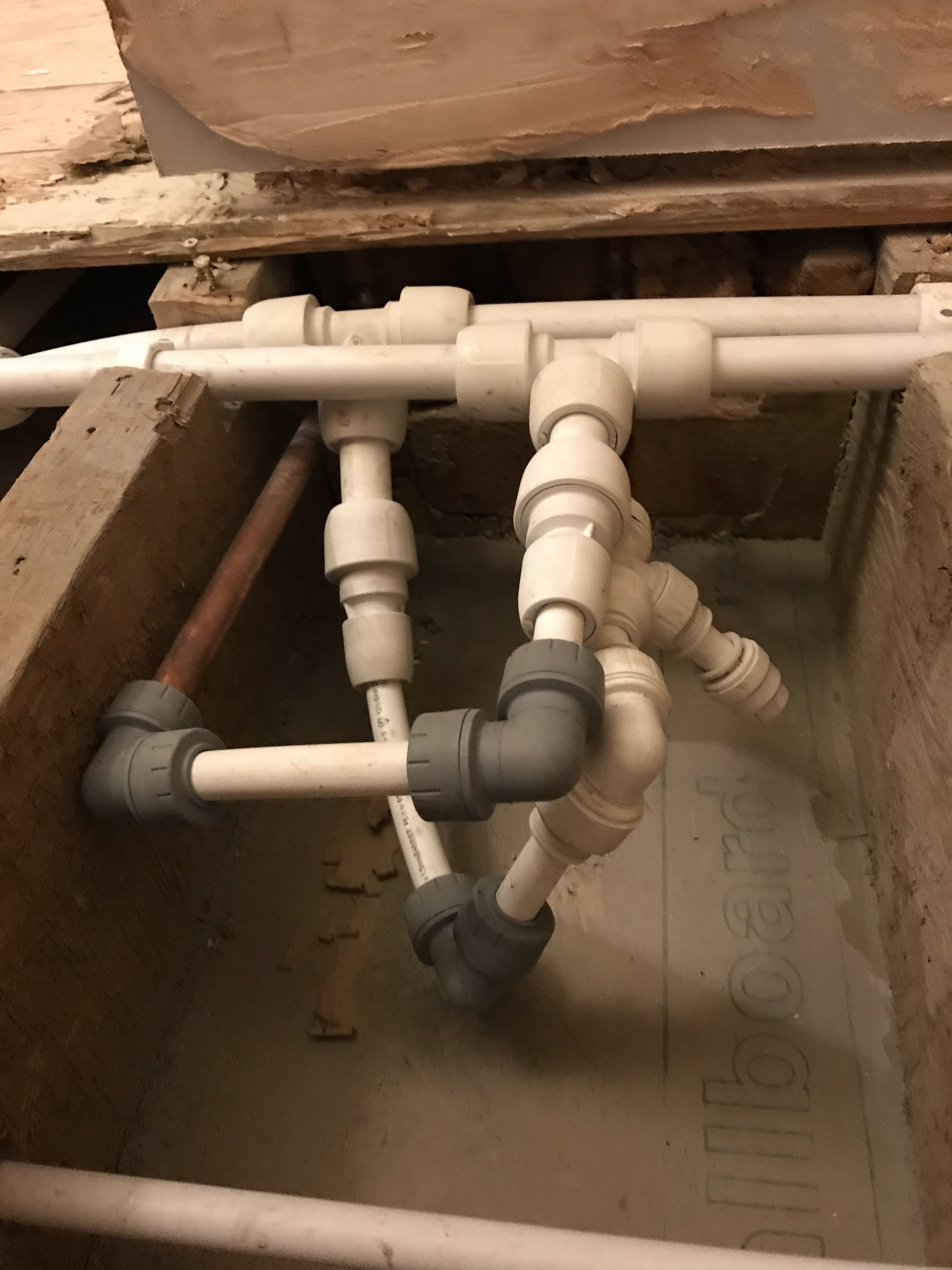

So, the boss of the new plumbing firm I've gone with came round this morning to take a look at things. (Tiling has now been postponed to give them time to clear up the mess created by the first plumber). He wasn't happy about sink/bath/basin all going into one waste and has recommended running 3 new wastes into the soil pipe. These will have to dropped down to just below the ceiling in the lounge and be boxed in, as drilling even more holes through joists is definitely not an option.
He has also recommended cutting out the shower pipes to allow for copper elbows to come out of the wall, as currently the bit of copper coming out of the wall goes straight into a plastic pipe and the two pipes aren't even level!
Agree with him but you can combine the shower and basin in 11/2 as it's very unlikely your going to be running the basin taps when someone's having a shower even then it would be fine
On that basis, couldn't the bath waste also be combined with the shower and basin wastes, since it's extremely unlikely that we'd be emptying the bath whilst having a shower? Anyway, I got the impression the primary reason for separate wastes is to avoid water in one waste getting sucked out by another appliance's draining.
You would have to up the waste to 2" pipe but you could and stick an anti vac trap on the basin
Ah, I see, ok... so maybe just as easy to run 2 separate wastes? The one from the bath can go straight to the soil pipe. The shower and basin wastes will now have to drop below the joists and run tight along the lounge ceiling and be boxed in.
Yea or run the lot in 2" and box it in and strengthen the joists

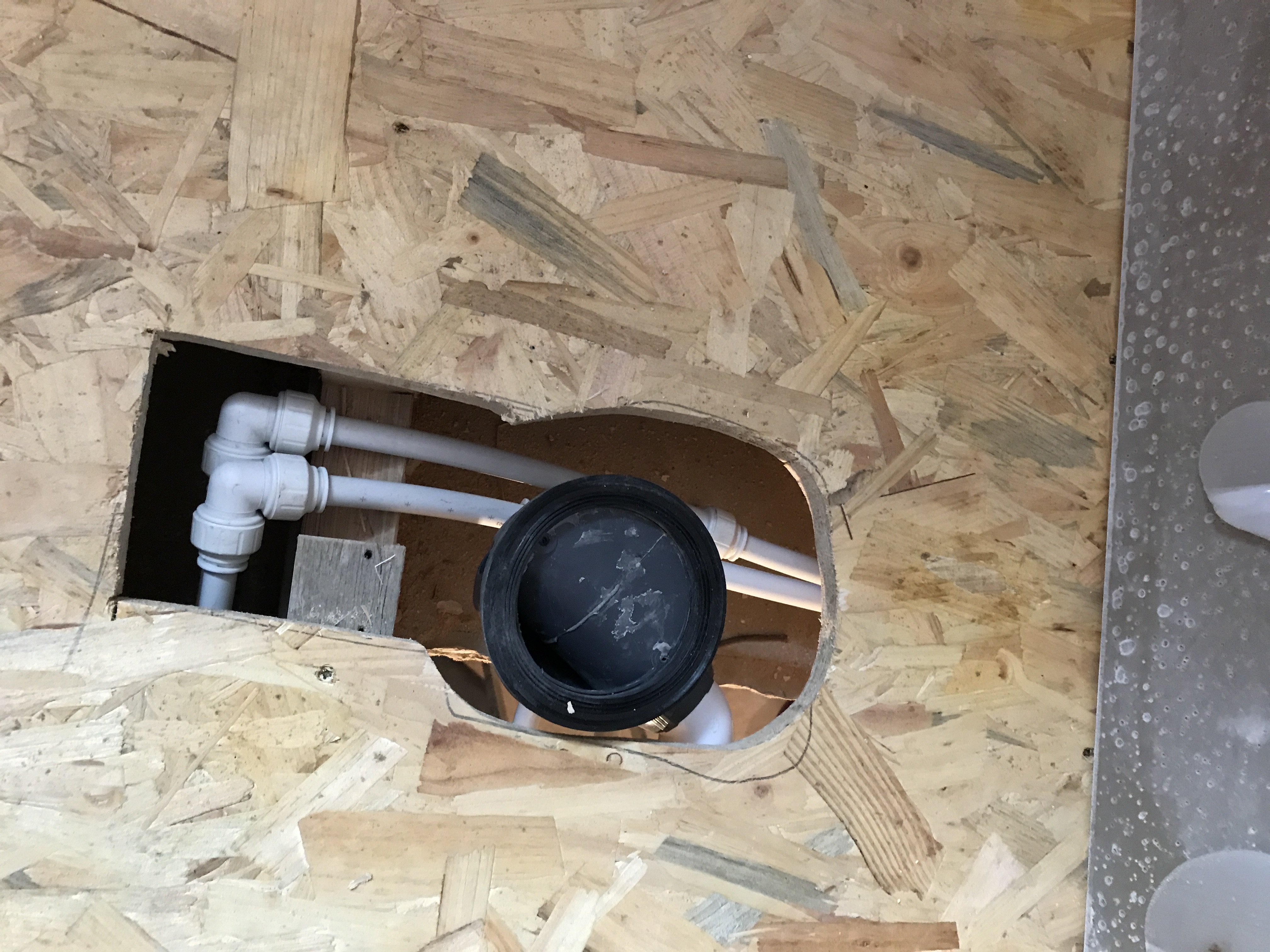

So, new plumbing firm is coming tomorrow to re-do all the waste pipes and fix other issues. They will leave me to fit the new flooring over the weekend (not quite sure why, but I'm more than happy to do it and can at least be sure of what's happening if I do it, esp. now I've discovered the muppet that was our previous "plumber" screwed down the 18mm OSB with about 25mm screws!!).

So, the top half of the cast iron soil pipe has been cut out and replaced with plastic. All the waste pipes have been re-run so that each appliance has its own waste direct to the soil pipe, and amazingly this time around with a fall (3rd time lucky!). The shower pipes now come out of the wall on copper elbows. They have also been set at a lower height which will allow the riser and shower head to not disappear into the loft!! I have absolutely no idea what I (sorry, Plumber No. 1) was thinking there! The hot and cold feeds for the towel radiator, bath, sink and toilet (i.e. everything else!) also had to be tweaked. The pipework going to the shower has also be rerun so that the shower waste doesn't push down on it. All pipes have also been clipped to the joists.
All in all, I think this is a much, much better job and it's now very clear just how terrible the 1st "plumber's" work was.
[For the avoidance of doubt, I'm just playing along with the cynicism (if you can't beat 'em, join 'em), but neither the previous work nor the remedial work were carried out by me.]
I should have mentioned that the shower waste isn't complete yet, hence the waste pipe that suddenly stops. It will be finished after the shower tray has been correctly re-laid on sand & cement.

New plumbers used Hep2O, hence the sudden change in fittings. There are a handful of the original plumber's Speedfit fittings still in place, but I'd say 80% of what he'd done was ripped out and redone.
Also, I got new plumbers to check previous guy had used the inserts that someone on here mentioned and he had at least got that bit right.

And can anyone advise whether this bit of pipework going to our towel radiator is ok? The fat pipes (22mm?) are the cental heating flow and return pipes, so it makes sense to come off these, of course. But the thing that caught my untrained eye is the fact he's used a T piece as opposed to a straight piece, so there's a capped off little orphaned section of pipe which is completely unnecessary.
That's a mess best to re do it if you can

The pipework for the towel radiator goes down before it goes up, so it shouldn't airlock, and it will probably work alright, but seems to be a mess of various branded fittings unsupported and installed under strain. I wouldn't entirely trust it.
I'm not expecially worried about that short bit of orphaned pipe.

Thanks for this advice. The new plumber (who rectified all of the mess created by the first plumber last Friday) came back on Monday to fit the shower tray and bath prior to tiling. I was supposed to have put down new plywood flooring at the weekend, but I left the 2nd piece loose so I could show him the scorched fittings and strange radiator pipework. He agreed that it would be better to change them, but after screwing down the last bit of flooring and leaving plumber to fit the bath, I saw from below that he'd only changed one of the scorched fittings. I think from the angle he was sitting it wasn't possible to see how scorched the second fitting was, so he probably only saw a bit of smoke damage. Anyway, he changed the worse one and the one most likely to have suffered internal damage through heat conduction down the pipe (good point you made about this, as it hadn't even occurred to me), so I guess everything should be fine.
He also removed the strange T-piece on the rad pipes, but didn't redo the whole thing.
Re. the mix of fittings, that's because the plumbers who did the radiators used Hep2O and our first 'plumber' used Speedfit, so I don't think it was one guy mixing them. Or is it best practice to carry on using the same fittings that are already there?
