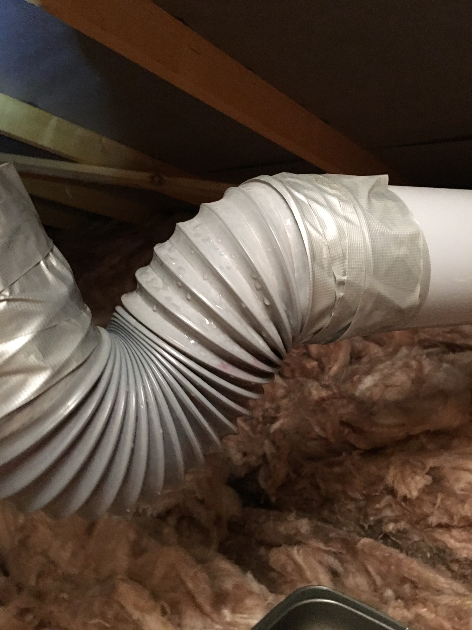

Hi. Still chasing our house builders regarding snagging. We have had a leak through the attic from condensation from the soil pipe. Can anyone tell me if this is acceptable workmanship? The house is one year old. Duct tape holding it together!

I bet it’s not even held in properly at the top? Mine wasn’t when I moved into a new build. Fitted a giant jubilee clip to it myself in the end.
Thanks for feedback. The home builder is sending an inspector out to examine but I wanted some advice beforehand as they have a habit of trying to assure us that their work is valid. Just waiting on the excuse for this one. I take it the duct tape for this use is not acceptable? It certainly doesn’t look very professional! Is the flexi pipe the correct piping?

Duct tape not acceptable as not considered a permanant fixing. Ask him if the vent has been air pressure tested to industry standard - 38mbar for 3 minutes - and you'll probably have him confused.
They did this where I used to work only the ducting was around 6 metres long. It filled up with water and then leaked through the ceiling. I removed it and fitted a durgo valve.

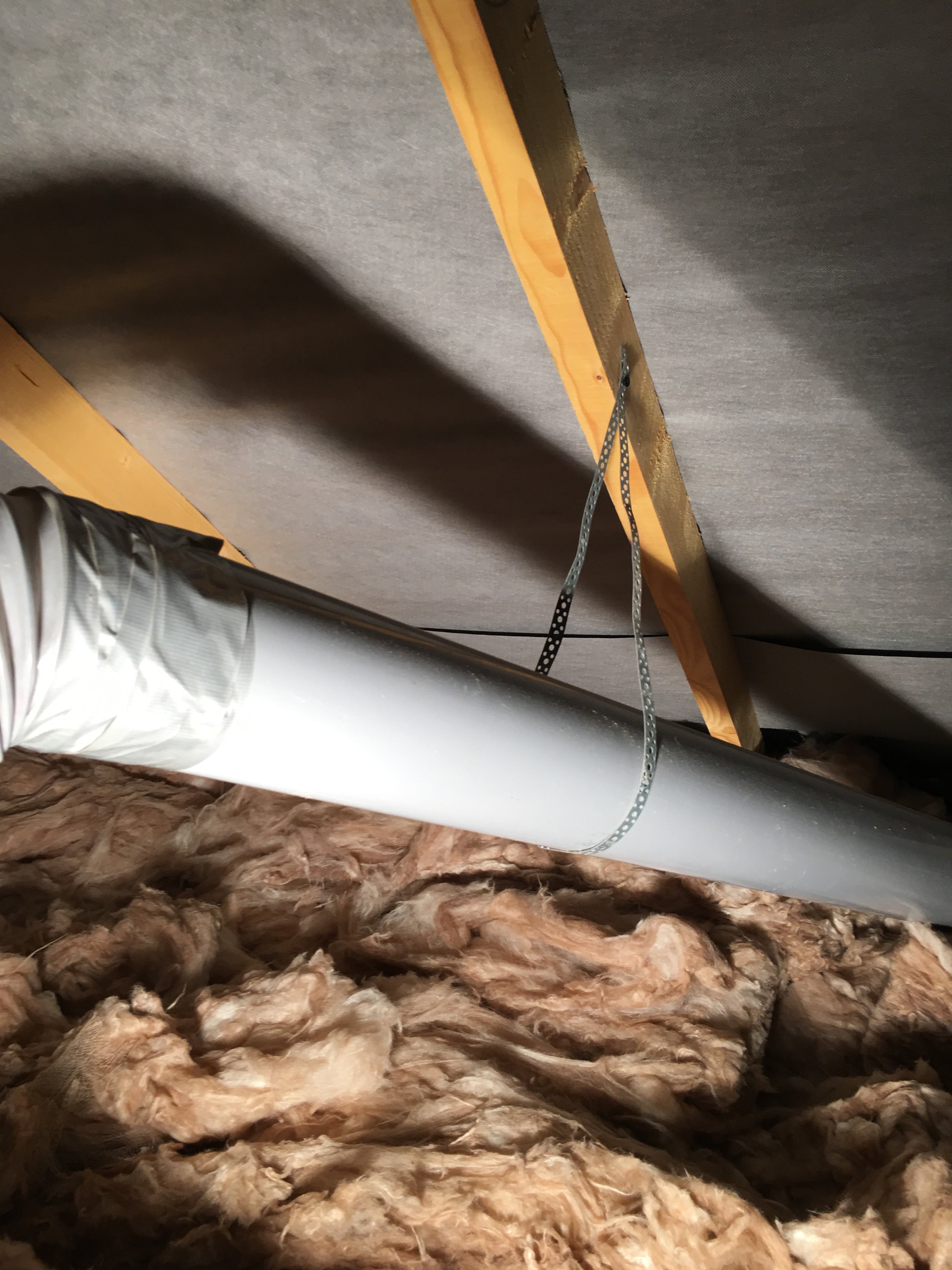

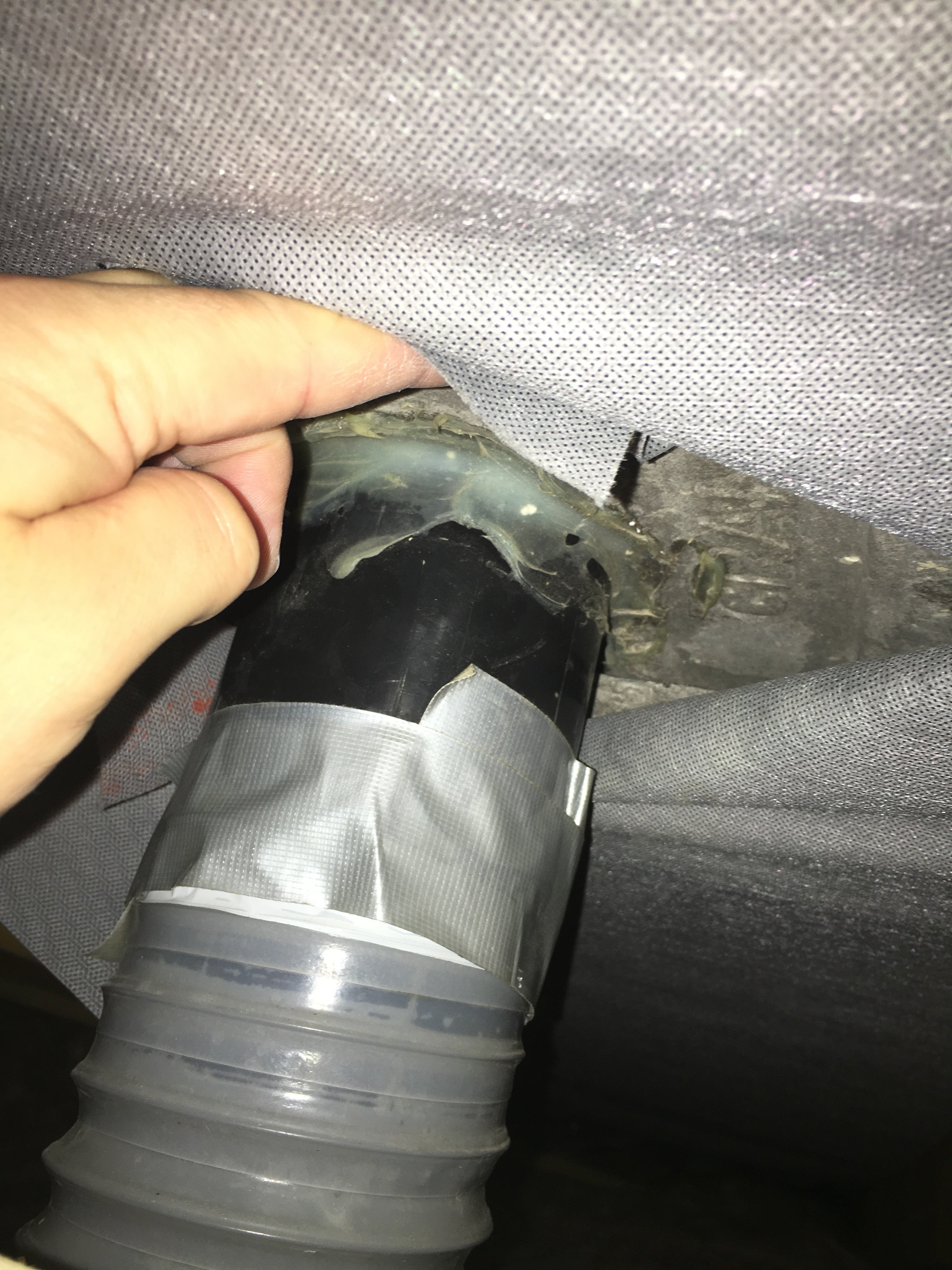

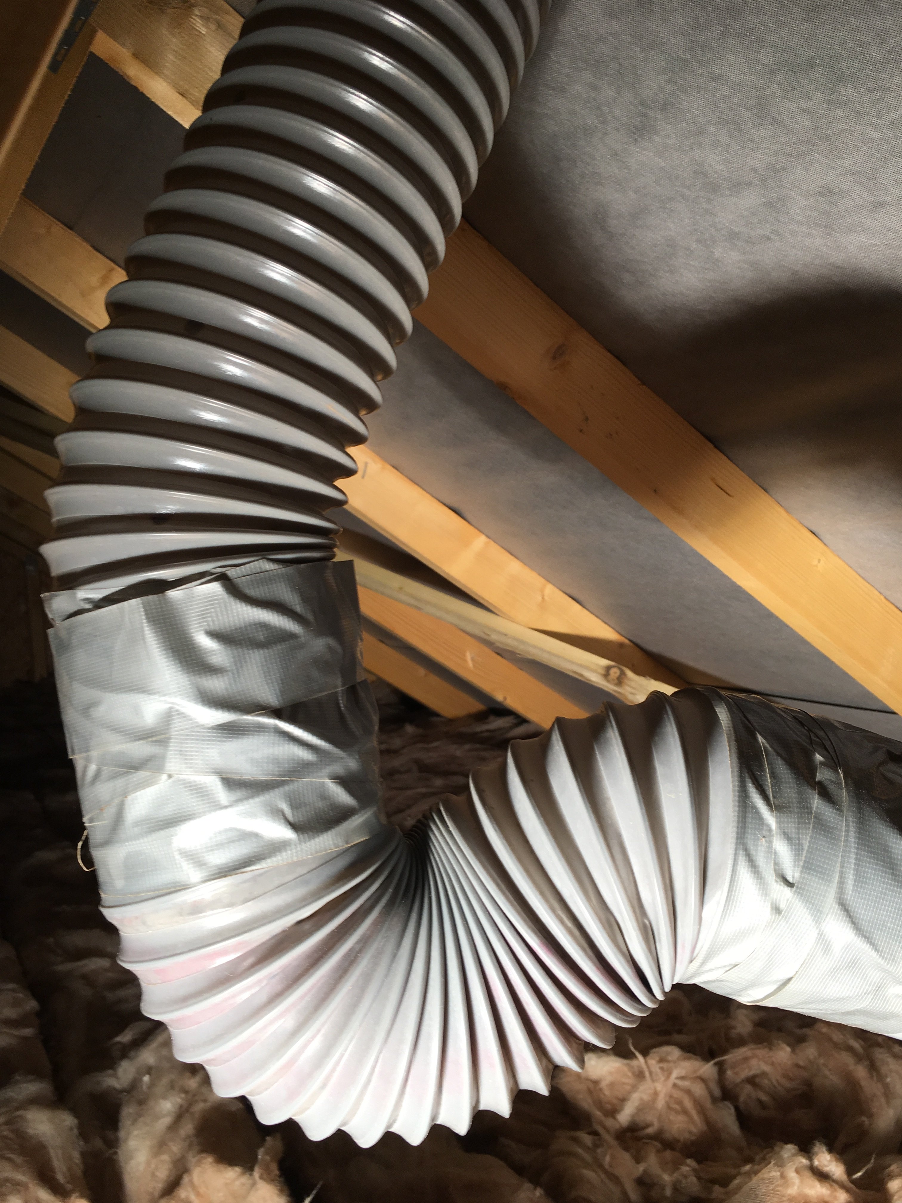

Thanks for all this info. Very useful and just what I was looking for. I took some photos today when I was up emptying the water tray AGAIN. This is how it is attached to the roof
