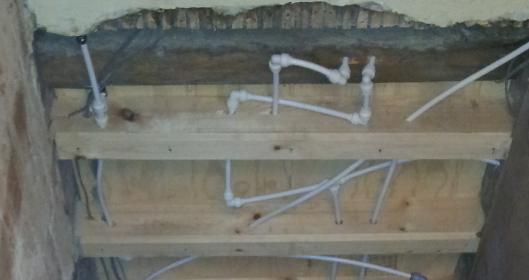

Pictures would be helpful. Properly installed, good quality, plastic shouldn't be a problem.
These pictures are fairly rubbish, sorry, I'm just trying to find some better ones. Please let me know what sort of photos would be useful- I can take some tomorrow.

probably hasnt used any inserts!
just seen the phots, doesnt look well planned re layout and mixed make fittings doesnt help a few pipe clips wouldnt be amiss
Thanks Mike, our plumber reckons he is buying good quality parts, he says the ones he uses are expensive. He has sent some of the problem parts to be tested.
speedfit fit needs pressurising up to 10 bar to ensure the grab ring has secured properly over an hour iaw the mfis, so i expect most makes need similar. inserts are fitting pushed into the cut end to support the pipe for the fittings to secure to properly. If I use plastic. I like to keep fittings to aminimum as theres less chance of leaks especially if your making them inaccessible.

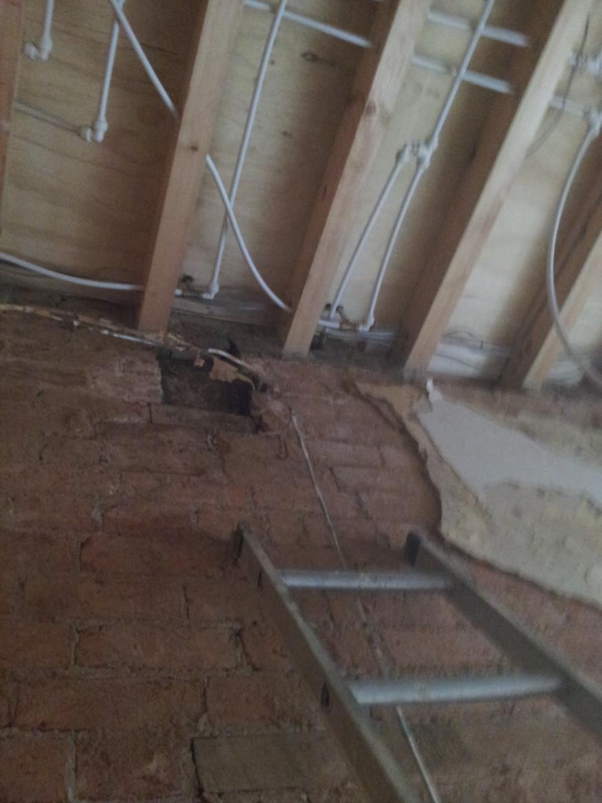

You have what look like Hep2O, Speedfit and compression fittings. To me it looks like somebody was just using up what they had left over. The pipes are supposed to be inserted at 90 degreees and won't tolerate a lot of misalignment. There's one or two fittings that look as though they are just waiting to leak. Plastic moves a lot when it heats up and cools down. As the pipes are moving they seem to be putting undue stress on the fittings and leaking.
if you get a leak down the line which firm will be responsible Hep (grey fittings) or Speedfit (white pipe)? So mixing makes isnt good. problem with trying to do everything right now you have been using it is are you going to dismantle and check every fitting to check for damage if its been moving down the pipe and sctratching it on the way or is it better to put it in new properly and only you and your plumber can make that choice. I wouldnt be putting my ceiling up yet

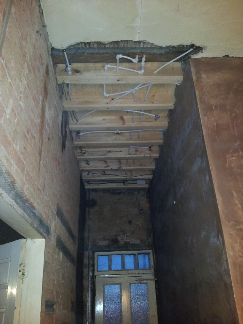

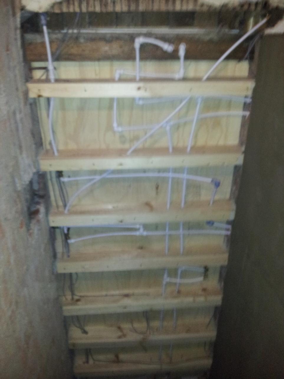

Looks like no planning has gone into the pipe runs at all. They are all over the place and there are a lot more fittings than are needed if planned correctly before starting the work.
As for the plastic, its fine if installed correctly. Personally I will always do a full copper install if I can, but that is just personal choice.

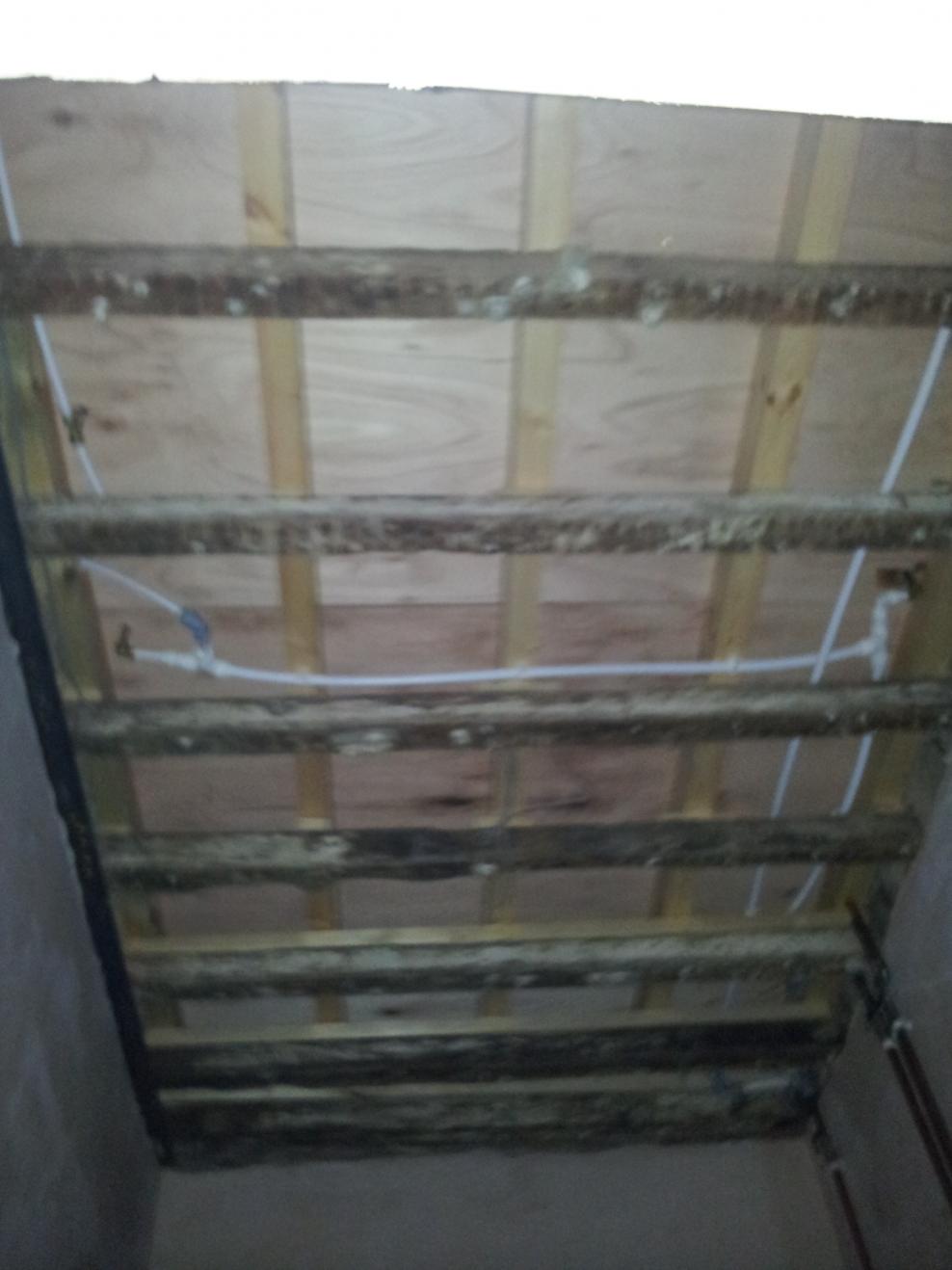

one example of poor planning is in pic 3. the big loop off the tee could be done away with if the tee was round the other way
