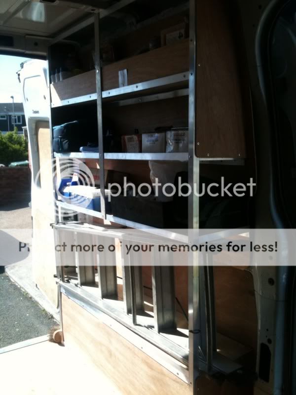

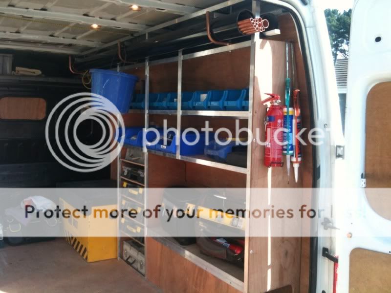

Following on from the thread in the other section about van racking and keeping them tidy etc, I said i'd upload some pic's in here (away from prying eyes) thought you boys might want to see what I was talking about.
Only just got the van and only just set up on my own so not a great deal amount in there yet, although everything that is in there was 'donated' from the firm that laid me off :smug: (including van vault and bins)
Cost me £80 for the aluminium angle which was 9x 5mtr lengths of 1"x1"x1/8" the last van that I did I used 1 1/2" instead which was stronger but nearly twice the price, plus it was a VW crafter so had to span longer distances. This stuff is fine for this van (transit MWB semi high) It's all pop riveted together so easy enough to do, I used a 1mm cutting disc on a grinder to cut, and it's very light but strong. I think it also will add some value.
I also fitted a new ply line floor and walls and the timber for it all was £80 which included the shelving although I did recycle some of the old floor in places as I am on a tight budget being a new set up!
So I reckon £150 all in would get you it all if anyone is interested in the price. The biggest expense is time, took me 3 days to fit out, although for me it's not so bad as I haven't got much on and makes sense to do it now rather than when/if I get busy, having to take time off work.
The twin rocket launcher pipe rack is ideal as it keeps it all inside and safe, but also I can separate plastic to copper which stops the plastic getting all marked up, I do a bit of electrical work as well, and nothing worse than manky trunking!
Hope that helps!

Looking good. Almost identical to mine but in reverse! I've got the metal storage racking fixed in the space above where your van vault box is, but at the other end of the van and the wee blue storage boxes clip onto it for all my fittings, although I also fixed a self tapping screw through each box to stop them falling off when going over speed bumps!
How long for is anyone's guess!
Good to have a spot for everything though, can easily find it and replace in the same spot. Forgot to add, the wheel arch boxes are all accessible from the back so I have got metre long drill bits, tube benders, long level, full size broom and short length's all going in there rather than waste the space.
Looks great mate. Same van as mine. Wish I had seen this before I did mine all with timber. Never occurred to me to use aluminum. Well done.

i woulld have used square line guttering for the pipes, then you can access the smaller lengths?.
Other way around redsaw, I nicked all the gear thats in my van! :ciappa: Going to stock up a bit tomorrow but I have all the basics for the work I do, don't really touch bathrooms etc so I have a box above the cabin which has a selection of waste fittings in which is enough for me.

I won't be putting cut lengths in there, only full un's, cut lengths have their own place in the wheel arch, the gutterings not a bad idea although would be a pain to support and always the chance of it flying out. I may see if I can add a length above it though for the odd longer than 1.5 mtr shorts lol. I would have just chopped off the excess and chucked the short bit in the scrap bag.
That looks awesome! Good price too, i'll be looking for something similar. Where did you buy all the materials a local merchant? I'd have to get someone to do the work for me but if the materials are that cheap I wouldnt mind!
I got the aluminium from Blackburn metals but this is the third van I have done like this so they recognise me, not sure if that mean't i got a better price or just being friendly! The last one cost £250 just in aluminium, but it wrapped around the bulkhead as well and was a VW crafter so a lot more of it, and I got the bigger stuff.
