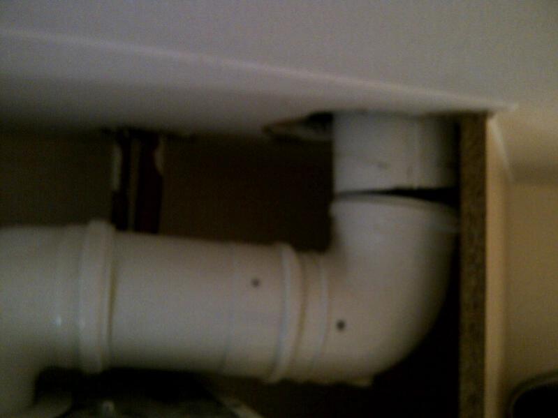

Called out to an Icos 35 he this morning, I even checked the availability of a fan on the way as tenant told me it was showing F8.
The boiler case could not be removed without removing boxing above the boiler, the pic shows what was found.
Not a single screw/support for the entire vertical flue, how it has lasted and held together for 4 years is ??
3/4 hours booked tomorrow to seal all joints, secure flue and make safe.
The installation has had 3 gas safety inspections by 3 different engineers, amazing.

I am getting tired of manufacturers being allowed to produce cheap and poor quality flues and connection joints,take this flue joint,look how shallow it is coming off the elbow and bet flue slips in and out so easily

really glad this was posted the straight legths of ideal 60/100 flue have a decant depth of socket and a reasonably deep lip i usually put 3 self tappers in the straight lengths but the 45 and 90 have a shallower socket and hardly any lip so i tend not to put self tappers in them i think in future i will put 3 self tappers in them as well agree with puddle flues are poor quality i use unistrut and clip it as well and there still not as sturdy as i,d like
