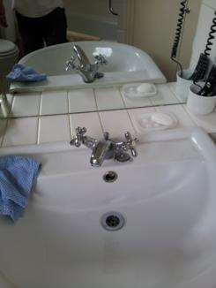

Yesterday I went to a job where the basin tap was very loose (hey, when you start, you take ANY job). It was a tap from a well known DIY (.com) company just like that one (in fact it was that one):

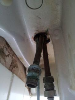

It looks like a pillar tap but doesn't have the expected 1/2" nut to tighten it to the basin. It has some sort of hybrid ring/circlip, the remains of one can be seen on this picture, completely corroded:
I ended up changing the whole tap (for another one from the same shop, with the same fixation system which will rust out in a few years as well, no doubt).

Looks like normal basin fixing, clamp & nut rubber washer , proberly find tap not seal'd so water getting under it, dont trust seal that comes with tap (`O` ring) use somthing else between tap & basin.
Should have used silicone to make double sure... I'll put it down to beginner's mistake, though in hindsight I should have thought of it.
it's possible that the tap wasn't centered on the hole correctly so letting water through to corrode the clamping piece as jtsplumbing said.
