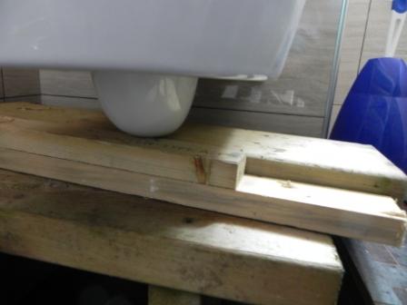

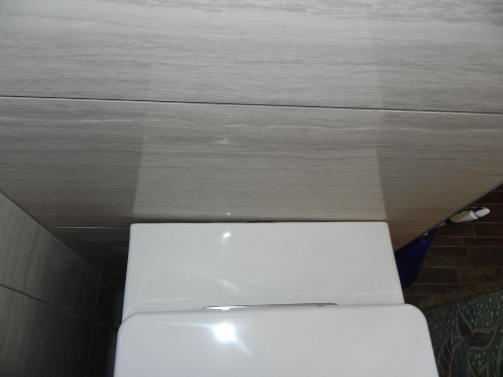

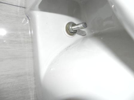

The plumber sent his minion this morning. He took off the wall hung pan and we confirmed that the nuts on either side of the concealed cistern frame (which holds the rod that the wall pan hangs on) are loose - so loose in fact - one was about 5 inches away from the frame.
The plumber is blaming the minion for tightening and loosening the rod - and making the nuts move away from the frame. This is a SIAMP BCM350 frame.
He insisted that the minion should put his hand through the hole (for the soil stack) and screw the nuts back against the frame on either side to dead lock them.
The wall plate has been over-tightened (due to the loose nuts) and now we've noticed that the bolts on the wall plate have cracked the thermaliteMy question is: If they insist that they can do repairs without dismantling the cladding and tiles from the concealed box - are they talking utter rubbish?
When exactly should I put my foot down and say - enough is enough, just give me my money back and I'll get someone else to do a proper job? Marcol SIAMP 002.jpgMarcol SIAMP 003.jpgSIAMP (7).jpg
