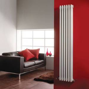

Have a look at somewhere like Best Bathrooms.There are some tall thin designer rads. which offer the required output.You would need to be aware of possible issues when the door opens as often these can protrude further from the wall.Prices £120 upwards.The other obvious issue,they are not suitable for towels!! I have a small rad. in small space at end of bath + towel rad.,always pleasantly warm.

Thanks for the ideas guys...found a tall column rad I quite like and going to couple it with a small towel rail, that should match my btu requirement.
