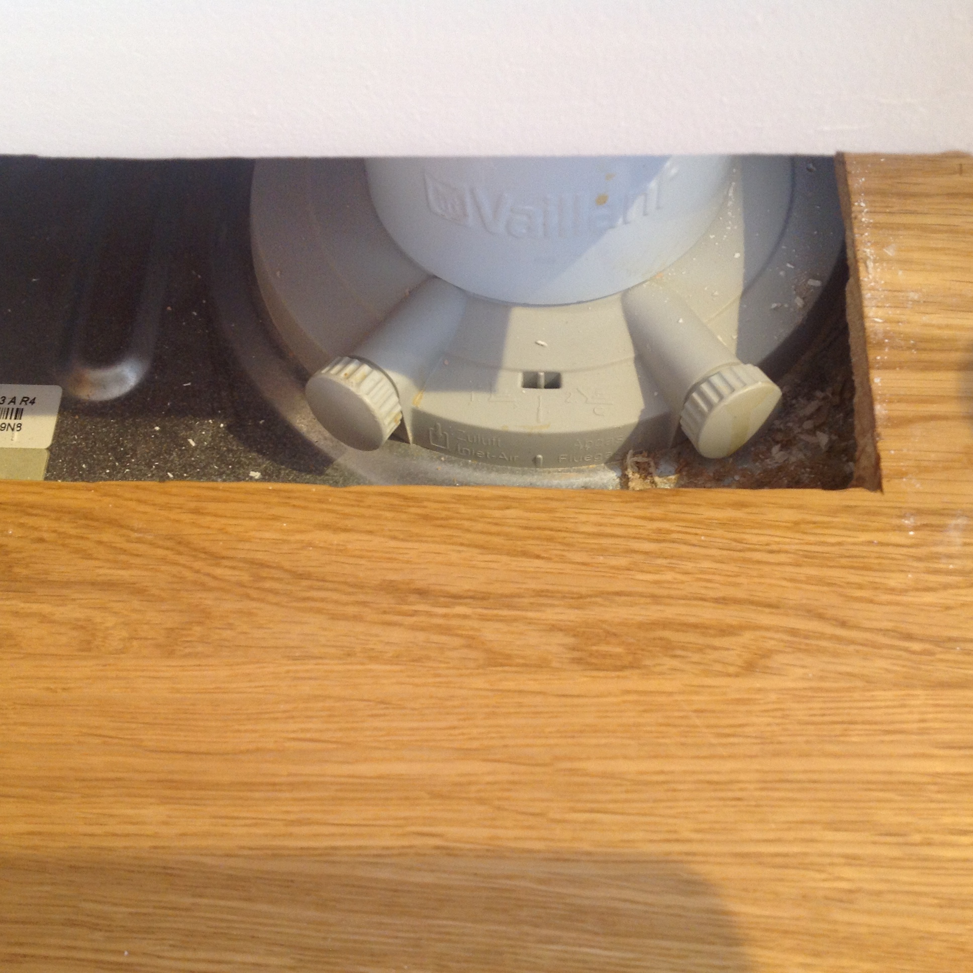

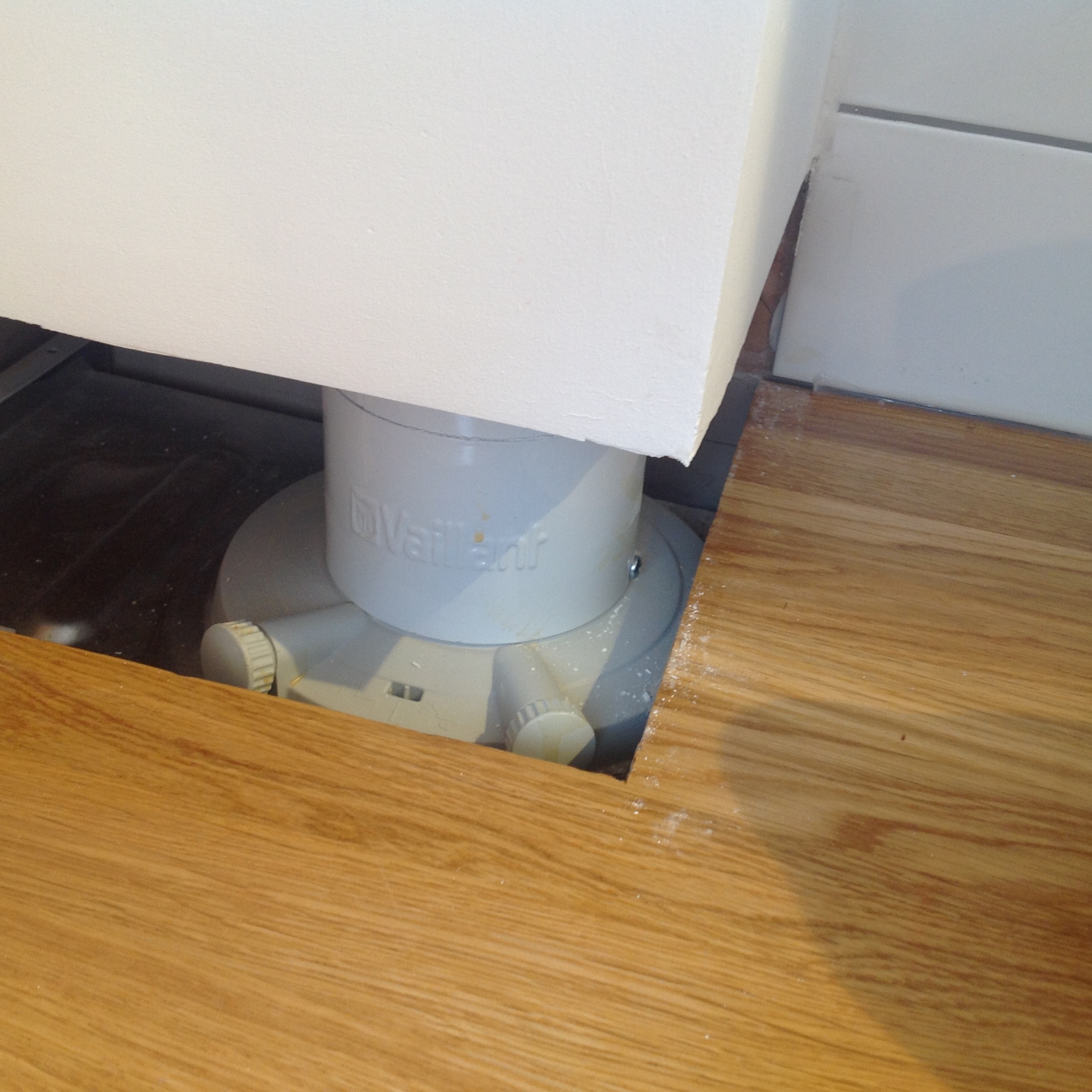

I have a Vokera Compact A combi boiler. All the clearance distances around it required by the manufacturer for servicing are good. However there is not very much space in front of the access caps/nozzles at the bottom of the flue. I understand that these caps are used when the boiler is serviced to check on the gas composition inside the flue.
I have been told that a standard gas testing flue kit has a straight unflexible copper tube that goes into the flue for testing. The issue is that because there is not a large clear distance in front of the caps, an unflexible tube would not fit in.
I am told that some engineer's use a flexible pipe to go inside the flue through the screw caps. Is that the case and can I expect all servicing engineers to have a kit that has the required flexible pipe?
There is a good chance that an engineer will not be able to service the boiler if he can't get a flue gas analysis. They will write that down as a fault on the service paperwork and may not even service any of it until that is accessible. Depending upon the flue terminal location they may however be able to get a reading there instead which may be acceptable. I only ever worked on oil though so gas boilers may be different in that regard.

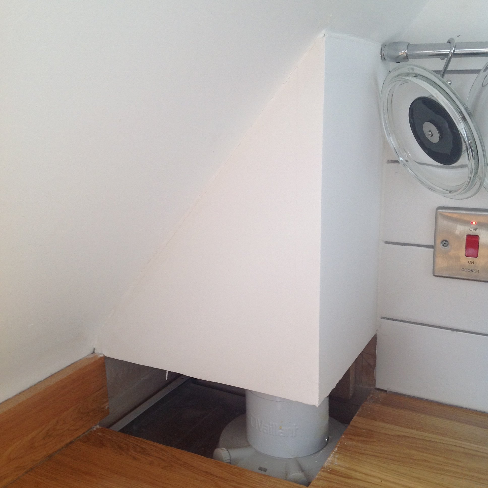

Thanks for your comments - here's some photos.
That's not good where does that boxing go ?

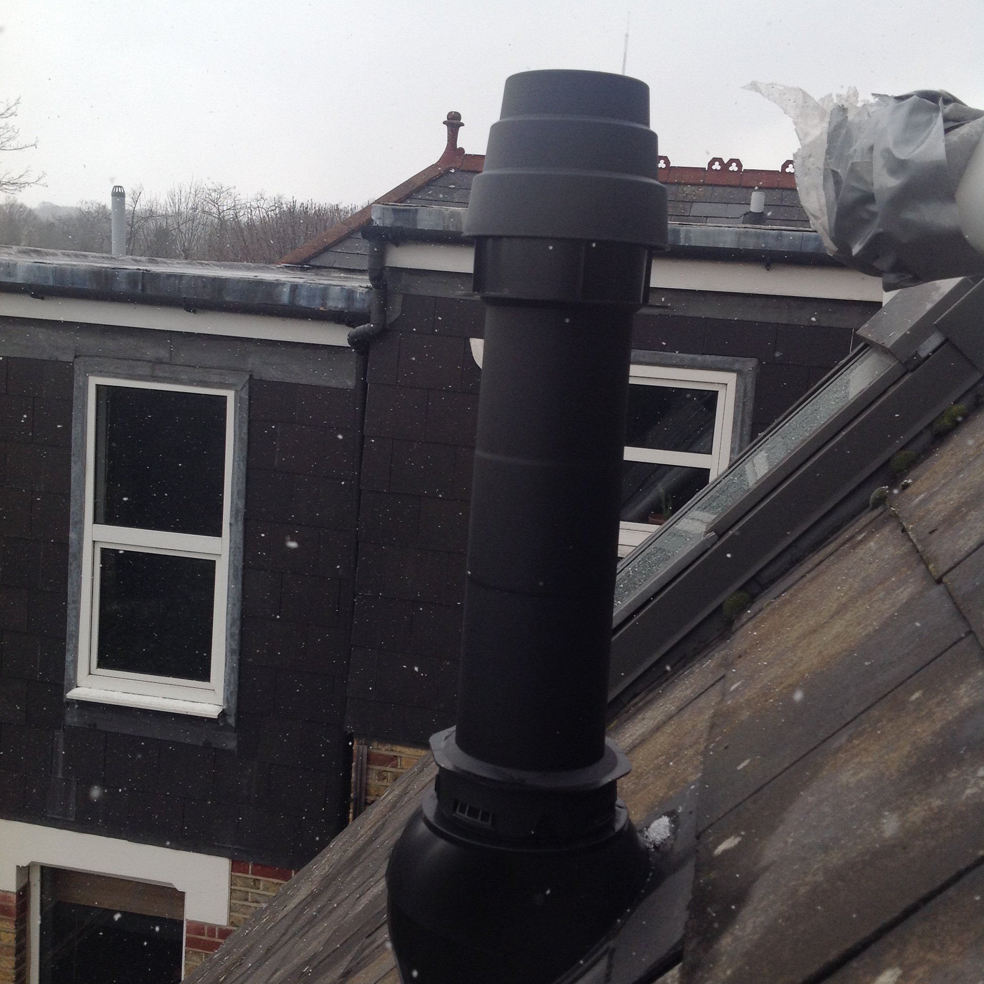

It goes straight through the pitched roof into the vertical flue terminal.
The vertical flue terminal is accessible from an adjoining roof window but of course it's one of the new black plastic ones that look very watertight - and hence probably are also maybe "gas flue testing tight"....
Yes that would work. It’s working on the assumption that they have a Kane analyser, that they haven’t already spent out on a CPA1 kit and that they don’t just see it as preventative how the kitchen fitter has cut the cupboard. I wouldn’t buy a flexible tester just for one job
It would strike me as the easiest option to just cut out more of the cupboard top or completely remove and create a removable top if it’s important that it must be covered

Indeed! Although to be fair, the manufacturer's instructions don't refer to a space required in front of part of the flue.
There will be a dimension for above the boiler and yours clearly does not meet that requirement. Is this the same install you were asking about last month?

Bloody hell yes you’re right. It is isn’t it. It’s not a cupboard. I was too focussed on the flue
How the hell are you supposed to access that boiler for servicing ? this is a joke ! can you put photo on of boiler please ! why was it fitted below worktop ? Think you will find most GS guys would walk a way from this one, what happens when it go's wrong ???
As far as getting the flue analyser in, i've used just a bit of u-gauge hose before, and one of the pressure testing attachments in my Kane kit, it only needs to be able to draw the flue gases in at the end of the day. Looking at how tight that worktop is to the top of the boiler i'd be surprised if they can either get the front of the case off to be honest, they lift off upwards.
