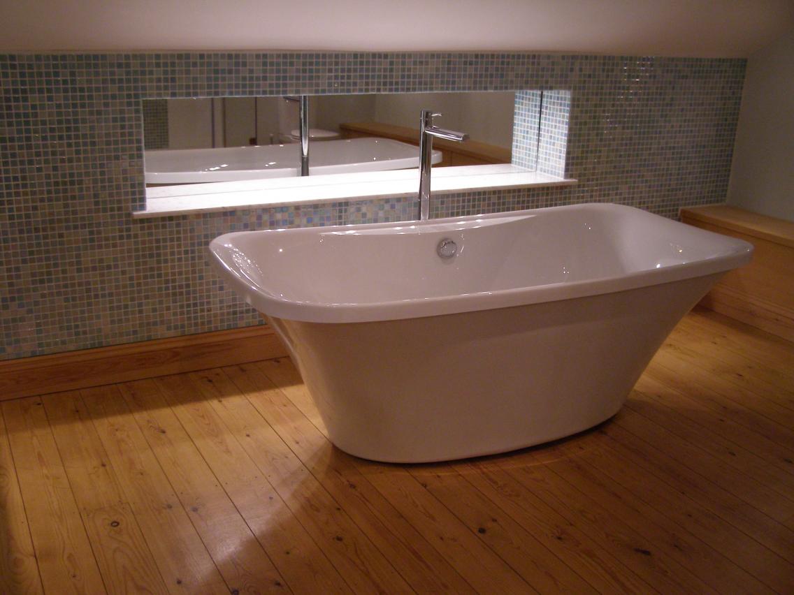

Just had the trend fitted into my bathrooom and on the internet looking for advise as I am not happy with it.
My plumber had a hard time fitting it but I dont think he followed the instructions properly. There is an internet video to watch that demonstrates how to fit it and if he had watched it as I advised he would have saved a lot of effort.
However these are the issues I have with it: Firstly it feels cheap and flimsy (I didn't choose the bath my girlfriend did). A free standing bath needs to be solid imo and this isn't.
Secondly there is a fair amount of movement if push the bath - At this point I am unsure whether my plumber fitted the floor mountings which I will double check tomorrow but I am also going back to the Bathstore to ask what my expectations should be.

Bathstore stuff is fine as a middle of the road choice. We tend to fit Fluidmaster siphons and inlets for the toilet as a matter of course. A sturdy frame can make all of the difference to the bath's feel. The free standing ones work well but the fixings could be better IMHO.

It is the freestanding version.
I had a chat with the plumber and he hadn't fitted the floor fixings, which he has now done. This has made a big difference. It's still a little squeaky - a plastic squeak and I am trying to see if I can put a stop to that.
There is a video online on how to fit the bath and I would recommend watching this.
