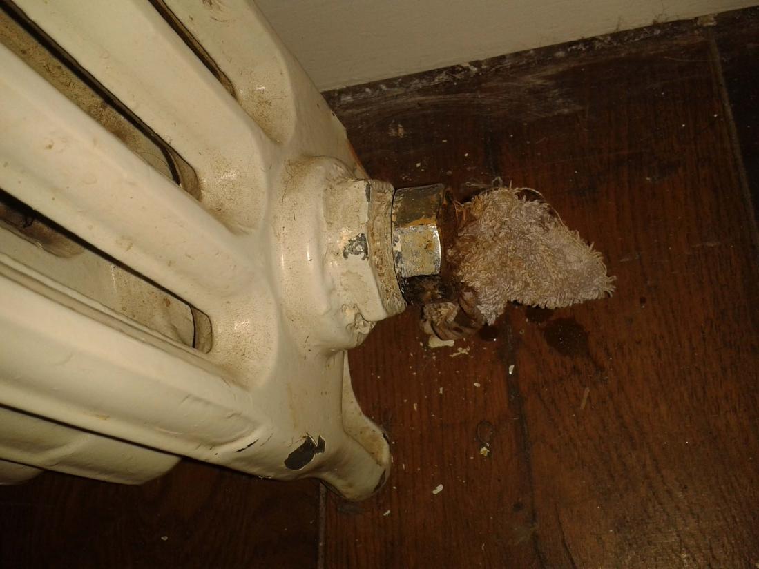

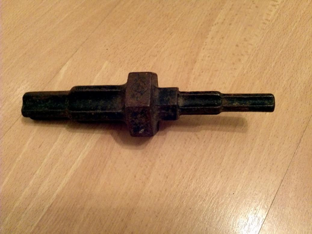

I went to install a couple of cast iron radiators today but failed miserably in removing the old fittings. The original bush in the radiator appears to be welded in place and the shank with the compression fitting to attach to the valve is too deep for my tool to be able to engage the internal pins, so I can't even remove that.
A pro refurb company are supposed to be phoning me back but haven't. When I've installed old cast iron radiators in the past they've always been refurb'd - au naturel is a new experience for me.
Any advice gratefully received...

Hacksaw? Hmm, you have more guts than me. 😉 If I knew I could repair any damage caused by doing this if it went wrong then I'd give it a go, but I don't so I daren't. 😉
You could possibly apply some heat to it from a blow torch to see if that helps loosen it up?
I considered this but the bushes seem to be welded in place, or sealed with something that hardens (I wondered if someone had got the JB Weld out at some point in the past) so I don't want to just steam in with heat and breaker bars.
Agree, cut through the nut opposite sides with a junior hacksaw with brand new blade & split it off, then heat with a torch & use grips with long handles. Any old rad valve might fit that nut though.
Yeah same as best sai,d I've done it before just takes a bit of patience, one of those shyte jobs while your doing it but you feel very pleased with yourself once done
Or bang in Handle side of footprints in and turn it with shifters or have even hammered in the top part of crescent 14" grips and stand on them turns round quickly.but would cut nut first easier!
Tried that with modern Footprints & if the tail is very tight, the metal tang of Footprints twists out of shape. Guess the metal not what it was.
Flax (hemp) with boss white will often weld up after a lot of years with hot water through the rads.
A bit of heat from torch might help weaken the grip the old tail has hopefully.
apply loads of heat with your lamp while trying to un tighten. this normally does the trick for me.
cut the tail almost flush then cut inside in two or three places tap the bit inwards job done why do you want the bush out ? remember one end the bush will be left handed thread
