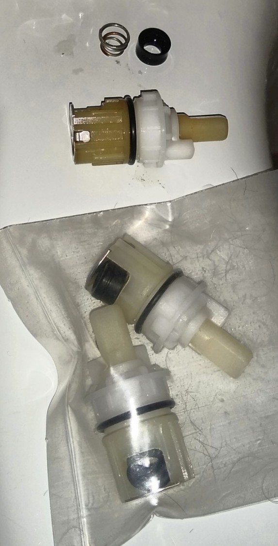

Tried posting this in USA forum, but I don't think it posted. I have an old Delta 3-handle shower/tub faucet. After replacing all 3 valve cartridges, when I set the temperature and flow I want, the cold water very slowly reduces, all on its own. I used silicone when I installed the new cartridges. This is not a pressure balancing faucet. What could be causing the cold water to keep diminishing? Any idea how to correct this? Here are the cartridges:
The cold water, after it decreases all by itself.

Thanks for the helpful questions! I'll have to get back to you on the first one. As for the second question, yes, the flow rate slowly drops, which is how I originally figured out that it was the cold water decreasing, and not the hot water increasing.

Yes, the center knob is the diverter valve. That cartridge was replaced, along with the hot and cold valves. I just tested the flow from the tub faucet, and it didn't seem to get warmer. When I switched to the shower this time, it actually behaved normally. First time it's done that, (kind of like when your car makes a noise, but it stops as soon as you bring it to the mechanic), so I'll have to repeat that test a few more times.
