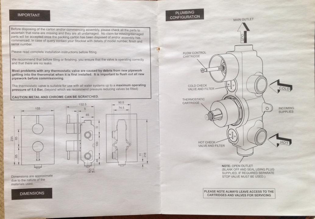

As per my earlier reply, it is a Matki Elixir EX5 Thermostatic Shower Valve.
many pictures on Internet but if it helps, various pictures attached:

i have taken apart the shower mixer (flow control valve, thermostatic valve, both non-return valves / filters) all of that was again absolutely clear. No blockages and no limescale build up at all.
