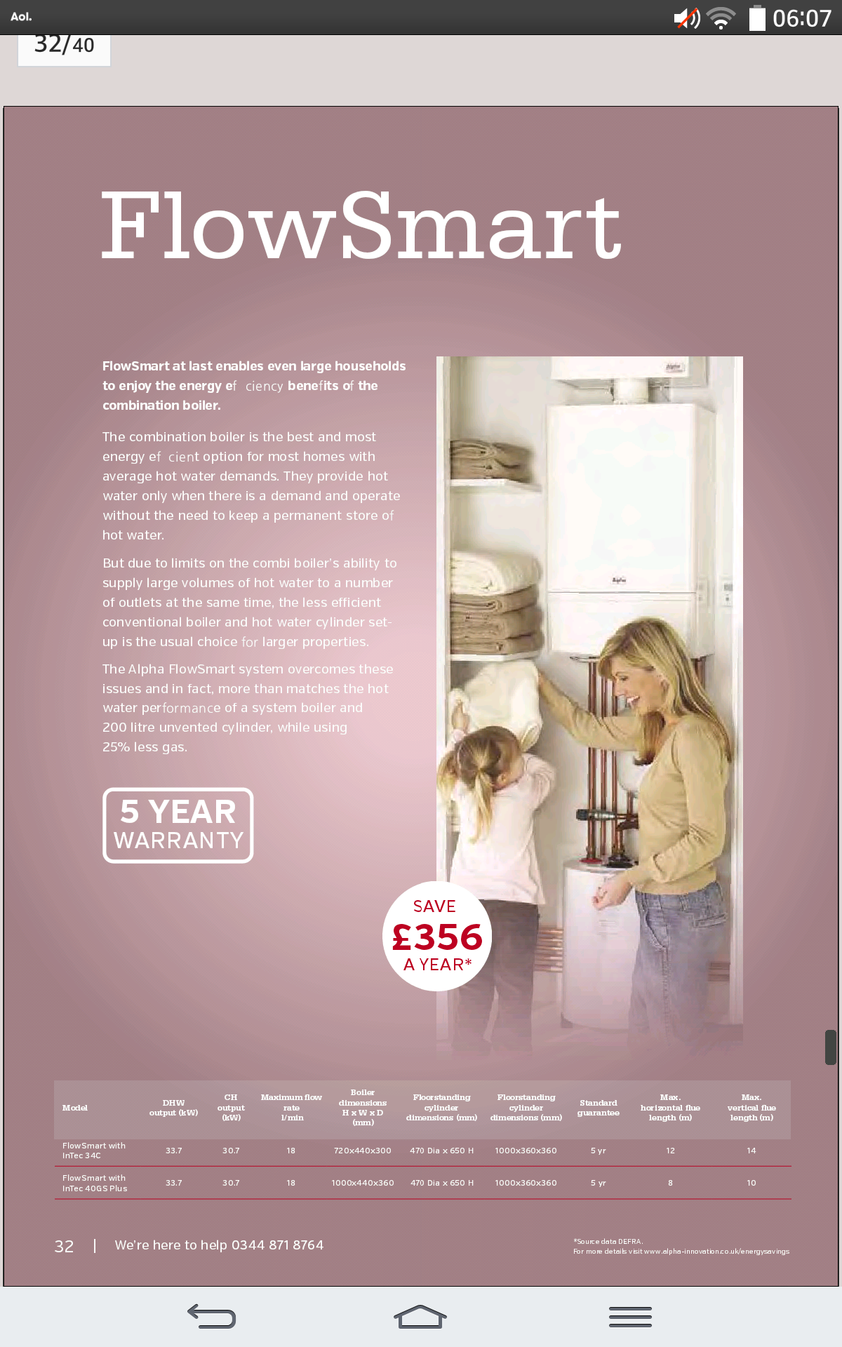

Your house your choice bud , i would personally recommend a heat only boiler and unvented cylinder but there are combis out there that can do the job alphas Flows smart for one , as others have said you would benefit from upgrading your incoming water supply first you can only get out what you can supply. Cheers kop
