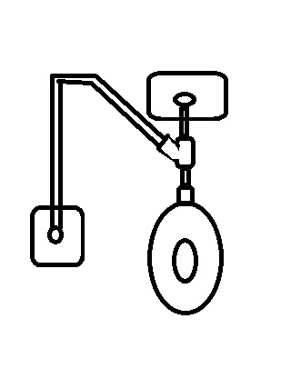

right, what you can do is....
cut the flush pipe 3'' back from where it enters the pan, then fit a 32mm mcalpine 't' to pick up the basin waste.
however, you will have to invert it a little and make a trap-arrester from the pipe arrangement from the basin to prevent the flush running up to the basin.
not look brilliant, but practical.
not look brilliant, but practical. I could even box it in 🙂
Cheers, will this mcalpine T fit the flush pipe - it's 38mm external diameter/35mm internal ?
and are they fairly widely available? Any chance of a link?

ah yes sorry,
it has to be the 40mm compresion type, i have done one before for a custard. you can get them from anywhere.

Will the 40mm compression seal on the 38mm flush pipe?

Reckon i have it sussed - even if the 40mm compression T won't seal on the flush pipe i'll use a couple of rubber flexi pipe connectors to link in some 40mm pipe for the T. Will also allow me to increase the height of the cistern, if needed, to improve the flush.
It will look like a dog's breakfast but i can box it in and will still be a dam sight easier and quicker than going through the wall and digging up the footpath to break into the drain. Thanks for the help guys 🙂

you can get them from toolstation, and they definately fit flush pipe as i did one to of-set a cistern last year.
