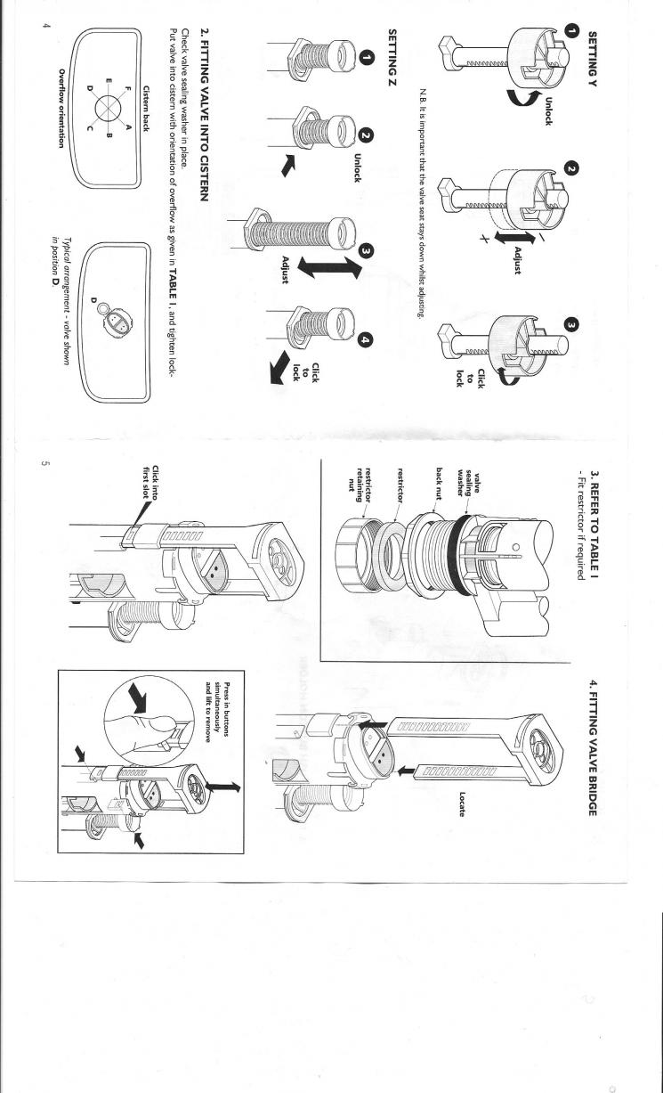

Thanks for that. It doesn't have a ball valve so sounds like the dirt. I have attached the breakdown of the mechanism if its of interest. Apprecaite the response. Cistern 1.jpg
the flush valve looks like a dudley cascade is it green and whit in colour the filling valve would be the old ball valve, its somtimes easier to call it a ball valve instead of equilibrium valve which its actually called but that not the point just see if it over flowing if so it the filling valve if not its the flush valve hope this helps
