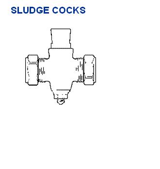

Butr on a serious note, what is pet cock/ sludge cock and standing waste?
Standing waste
1½" Standing Waste with 3½" Tail - Overflow Fittings - Overflow Pipe & Fittings | McAlpine Plumbing Products
Pet cock aka drain cock
Sludge cock aka scour (pronounced skoor) cock
