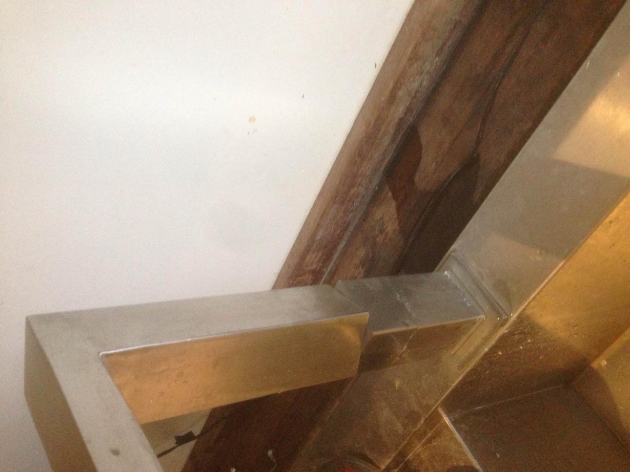

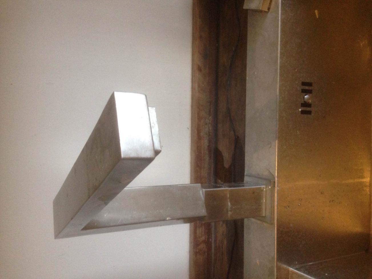

Bought a house recently with this tap in the kitchen. I have no idea what sort of tap it is! Does anyone know? The tap operates by twisting the middle section of the stem. However it has a slow leak (when in operation) from that twisting section. I have taken it apart and the seals look okay (although they may not be!). Does anyone have any ideas?
Harry
That looks like a very expensive waste of metal.
It's doomed to fail with age.
I would expect it to have 'O' ring seals above and below the twisting section, but wouldn't be surprised it it had a very expensive ceramic seal of some sort.
Although aesthetically it looks good, practically it isn't.
Pencil corner sink?
Ist search and I found it;
https://www.tapsuk.com/abode-vixo-p...-monoboc-kitchen-sink-mixer-tap-at1192-p10226
Not as expensive as I thought.
I'll change my statement to a cheap tap masquerading (not very well) as an expensive tap.
