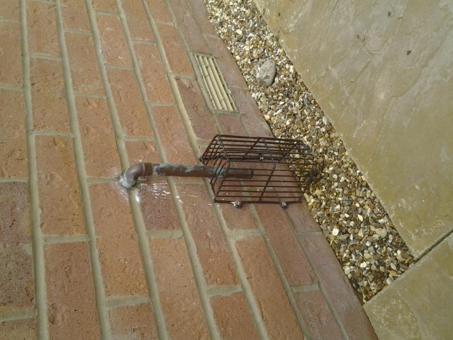

I have a flue outside my back garden door - it's dripping slowly and has been for a day or so. I am not sure what it is for, as my boiler is at the front of the kitchen. I do have a downstairs toilet, so it might be something to do with that - not sure.
Can someone tell me what this flue is for and why it is dripping? Is this an issue or is it normal?
Thanks - I attach a picture of the flue.

That's not a flue. That's the discharge pipe from your safety valve.
You need to get a gas engineer in. It's not a DIY fix.
Being 22mm it's got to be an unvented? so make sure the engineer you get in also has Unvented Hot Water certificate to be sure 🙂
I would say that was 22. It's probably undersized more than 8m! But hey NHBC you rock.
When doing cavity wall you can blast a 25mm hole easy between bricks on a bed joint.
Its 22mm because its alot bigger than the mortar,, if your on the computer enlarge screen a few times , but if the op could verify then that would be handy,,,
It ain't 22mm! Don't let the fact it's a larger picture fall you!
Look at the mortar joint. How thick would that be if that were 22mm pipe?
