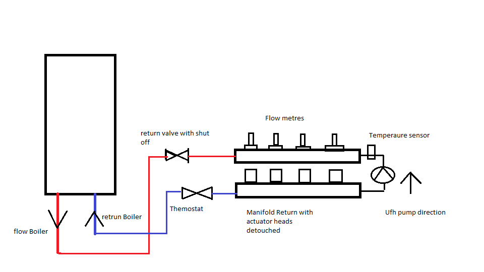

I just recently installed a ecotec plus 825 which is working fine. The customer is complaining about their only heat source which is ufh rehau.
The problem they experiencing is no heating. I have been out and investigated the works again. I have made sure the boiler is functioning fine as well as hot water so i can definitely say the boiler side of it is good.
The previous boiler was a very old baxi boiler which was connected onto the ufh in 15mm to the manifold. Customer has complained before that the ufh never worked properly and that someone came out and hard wired the ufh.
So, my problem is that whenever my boiler is running is pushes against the other manifold pump and in return it pushes back into the boiler flow. The boiler goes into the Burner anti-cycling time. It just indicates it does not get the heat away towards the ufh. the previous engineer took all the actuators off and the thermostat at the return side. i can see by pressing the pins that each zone is functioning and open. but somehow it seems like it never worked before. I obviously connected the flow to the flow side as it was before but i cannot seem to understand why it doesnt work.
Is it not better to take the pump of the manifold and let it run like a radiator?
I do not seem to understand the way they installed it. It could have never worked as the connections and piping is exactly the same as it was before.
It doesnt seem like to circulate. I always have to turn the pump at the manifold off otherwise it pushes back into the flow and the pipes gets really cold.

Close coupled tees before ufh pump
would that solve the issue? It seems like such a small bypass or hydraulic bypass would not make much difference.
unless you tell me that would work I would definitely give it a go.
could I do it right after the boiler as the boiler and ufh manifold sit in one room and the flow and return are very short runs.
i was thinking to install at the left hand side like in the picture above before the thermostat
There is no other circuit then the ufh with 6 small zones. They only have the ufh as heat source so somehow I think there is a setup of the previous engineers not quite right.

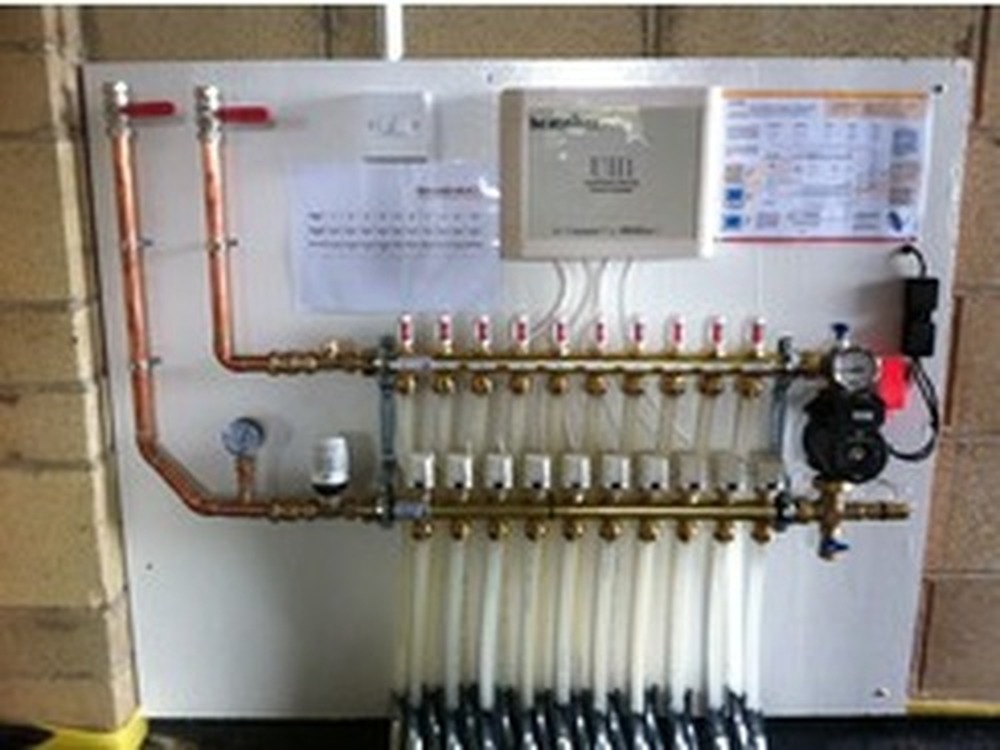

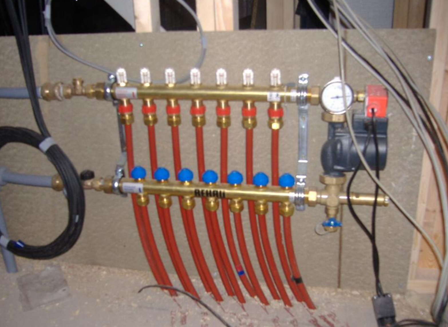

Here are the old pictures of the old setup. I just connected onto the old pipework which is shown in the drawing I did. It is even written with a manufacturing sticker what flow and return is so I tripple checked that as well as the old system.
Manifold is all wrong.
The pump set should be fitted to the isolation valves..
The other side should be blanked off.
Will never work and has never worked.

I also did a mistake but perhaps that wouldn’t make any difference. I connected the manifold correctly NOW but the old install had the flow at the bottom .... so I did actually not connect the system as I put was but did it unconscious in the right way
Furthermore the Manifold has no isolation valves at all. It is basically just the pump on the right hand side, a temperature sensor, and a manometer.
Left hand side you can clearly see it’s just the thermostat and the valve above.
Could you perhaps tell me what you would do to make that working? Would you change the whole manifold and start from zero or just fixing it somehow? I am a little stuck as i do not know what to tel the customer.
Perhaps it is my fault due to the old engineers swapping the flow with the return and I actually connected the manifold correct.
The pump arrow shows upwards into the flow which you can see at the drawing.

the flow and return manifolds are marked correctly the flow from the boiler connects to the return manifold Uponor do it this way as well
