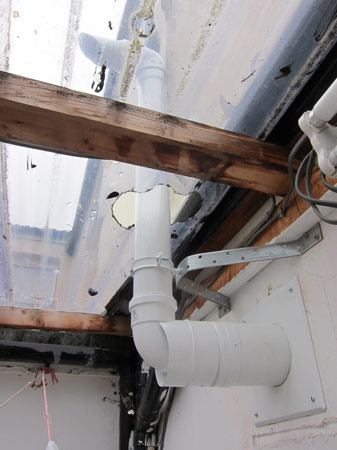

The plume management kit had to be installed at this address. It works a treat!

Worcester allow you the flexibility of fitting a flue 150mm from a window/door opening as long as the plume kit outlet is at least 300mm from the opening.
Plume kits are not just to lessen the nuisance factor.
You are still not permitted to have a flue terminating in an enclosed space with the outlet terminating above.
