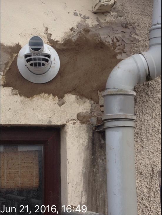

Hi to all.
My Questions :
If Flue Terminal Of Condensing Boiler Is Parallel to Neighboring Property distance less than 300 mm.
could we use a plume kit to terminate the fumes .
Some Regs Confusing ..Saying Flue Terminal has to be away at-least 300 mm from neighboring property if comes parallel..
What if We use Plume kit to divert the fumes in open Air..
I would really appreciate yours Knowledgeable Answers Guys.
Window is not openable next to the flue..
Regards
Ibby

What make of boiler is it ? Have to move stack also by looks of it lol
That looks like the new Vaillant flue. In which case you can't use a plume kit to correct non-compliant terminal position. And you're right, the stack is also too close...
Why 'O' why didn't you go with a vertical flue ?????????????? as Shaun says that looks a real DIY job wall outside messed up, extra work required inside , no supports on flue, What were you thinking of ? Have you had experience fitting vertical flues ? or even fitting boilers, If that was in my house I would reject it, a very shoddy job
Could be a lot tidier but well done for asking - and taking - advice. Keep learning, keep improving. Is the flue 300mm from the window opening? Looks pretty close to me.. As others have said, going vertical would have been a much better option.

Yes it's 400mm away from both sides , neighbors boundary and Window is closed , opens from other end ..
I don't do vertical flues buddy, reason people wouldn't pay extra for the roofer , even though
Customer wasn't allowing me to go vertical as they loft to store the stuff n toys etc ,
Had only this option , I know looks messy , but before was only 200mm away now bang on 400mm.
For clips flue coming from two cupboard holes been made to measure ..
Had there already vertical , would have been easy , making new routes hard for me .
Have you had much experience ? Don't know what part of Lancs you cover but your standard of work needs to be improved, if not your going to loose one of two things, Your reputation or your Gas Safe registration.
It does matter if you read the thread from start then you'll understand the real story , rather than making fun ..
I have read the thread from the beginning trust me and does it change anything no still doesn't comply with the regs
I thought vaillant plume kit was worded as termination variation and could be used to come over termination issues .have they changed things
why cant they standardise things .some flues can use plume kits some cant .some can have white on show others cant .can you imagine such stupid variable rules at car mot station - o its ok sir that's a ford it does not need front brakes
just put every flue like the worcester (can add a plume kit later on with no changing/fuss)
You can Mas, if you call technical they'll email it to you.
That's right is what I would say, if the window is shut but has trickle vent you have a opening?
I'm not sure I agree with that, it's like saying I can't flue out the side of a building in case a builder builds an extension over it. We need a bit of good faith in humanity and hope they will use reputable tradesmen in future who can advise accordingly or seek the appropriate advice.
what have i missed something, is this just a vaillant thing or has a new important rule passed me by
They brought a ruling in for opening in the fabric of the building, because there was a case where a new window was fitted with an opener. And ther was a fatality.
If you contact Vaillant, they'll send you some info, where as you can have it 150mm away from an opening instead of 300mm. With a plume kit.
I stand corrected! When I did the Level 2 training at Vaillant they said very firmly that it was a no-no. Obviously they've relaxed a bit now. Ideal were the same, I wonder if they've also changed their stance??
Most of the Manufactures that provide plume kits allow you to have the flue 150mm to opening as long as plume kit fitted as per MI's. Can't think of one that doesn't.
