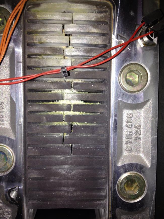

Serviced the above the other day which I was told hadn't been serviced for around 4 years and before that BG has done it on contract and were in and out in 10 mins.
MI states fan pressure should read negative - 3.9mb or greater, pressures measured below this figure indicate the heat exchanger will need cleaning.
Fan pressure was -5.87
FGA readings show CO2 10.1, CO 50ppm, Ratio 0.0004
I decided to give the boiler a full strip and clean anyway as I had not done one before and the CO2 was a bit higher than MI stated 9.6 max, 9.0 min.
When I opened up the combustion chamber to clean the heat exchanger the attached picture is what I found which to me looks like it was in need of a pretty good clean. Which then led me to wonder what state it might have been in if I had left it based on fan pressure or simply adjusted the CO2 levels to bring it down. I also wondered if this might be one of the reasons why some engineers are routinely setting CO2 levels wrongly as I hear on the boards.
For information, when I gave the heat exchanger a good clean the CO2 level dropped down to 9.6
Thought it might be a good point for discussion as I'm new to the trade and would value your views. Would be also interested as to the reasons why engineers are commonly adjusting levels wrongly so I don't fall down the same hole. 🙂

Ill be honest, I wouldn't have done a full strip down service if the fan pressure was ok.
The FGA readings can be adjusted, I find most boilers require a tweak anyway.
If you had left the boiler without stripped down gas safe couldn't have done anything as you followed the MI's and did what was asked.
Youll always find problems if you look deep enough into anything.
Me neither, that debris looks like it has accumulated as you have cleaned the above sections and taken the picture midway through the process? Either way the fan pressure was spot on so obviously its not causing a restriction.
Engineers adjust the gas valves incorrectly because they can't read instructions properly, nothing to do with what's inside the boiler!
Thats interesting i wouldn't have expected to find a build up of crap inside with the reading and fan pressure being what they are albeit the CO2 being slightly high.
Picture taken as found prior to cleaning. I wouldn't have stripped down based on the readings other than I hadn't done one before so a bit of hands on was really useful.
Fair enough, did you replace the seals as well? Quite a bit of debris there then, but not affecting the safe operation of the appliance it seems.
Readig your post again I would have recommended a strip down and seal replacement given the age of the appliance, but you couldn't do this to every appliance you meet as it'll cost the customers a fortune in new seals.
Yeah replaced seals as per MI, was more interested in what I found compared to what MI and CPA1 calls for would have expected it to be cleaner based on the FGA readings and fan pressure given that MI suggests it doesnt need stripping and cleaning ... Just goes to show 🙂

i did indeed as per MI instructions ... The point of the original post was more to do with what i found compared to what MI and CPA1 calls for would have expected it to be cleaner based on the FGA readings and fan pressure given that MI suggests it doesnt need stripping and cleaning
If i based my work just on the fga readings i would have prob checked gas rate the adjusted gas valve. So it seems a good idea to be able to check the fan pressures, hopefully more manufactures will take it up.

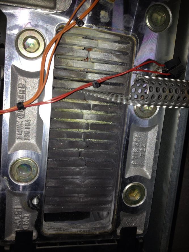

sorry thought you were taking the **** lol ... No it's more of a cleaning blade than a rasp (as below) and the bush is very small and slim, made for purpose I suppose.
where did you get that! Worcester used to give them out on training courses, but not anymore! I got the cleaning brush for the round type in ri & si boilers but not the nice rasp blade!
