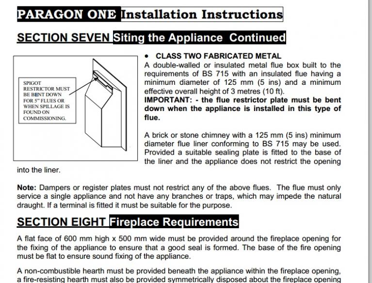

Gas Man :- i would rip an old one out no hassle (well my roofer would lol) I defo know there has been a new liner put down the chimney at the womens house long the road as the neighbours said they had to gain access to there own roof and put the cone was still on the liner. Her fire she has bought spigot restriction i have include what she has sent me lucy fire .jpg
Norstum looks ruff as france lol they have jammed fire board round the 5" liner to try seal the chimney breast.

First read the manufacturer instructions for your flue options. If it does require lining, its likely to be a minimum 125mm dia flue. I would always try to use a fire box as well.
