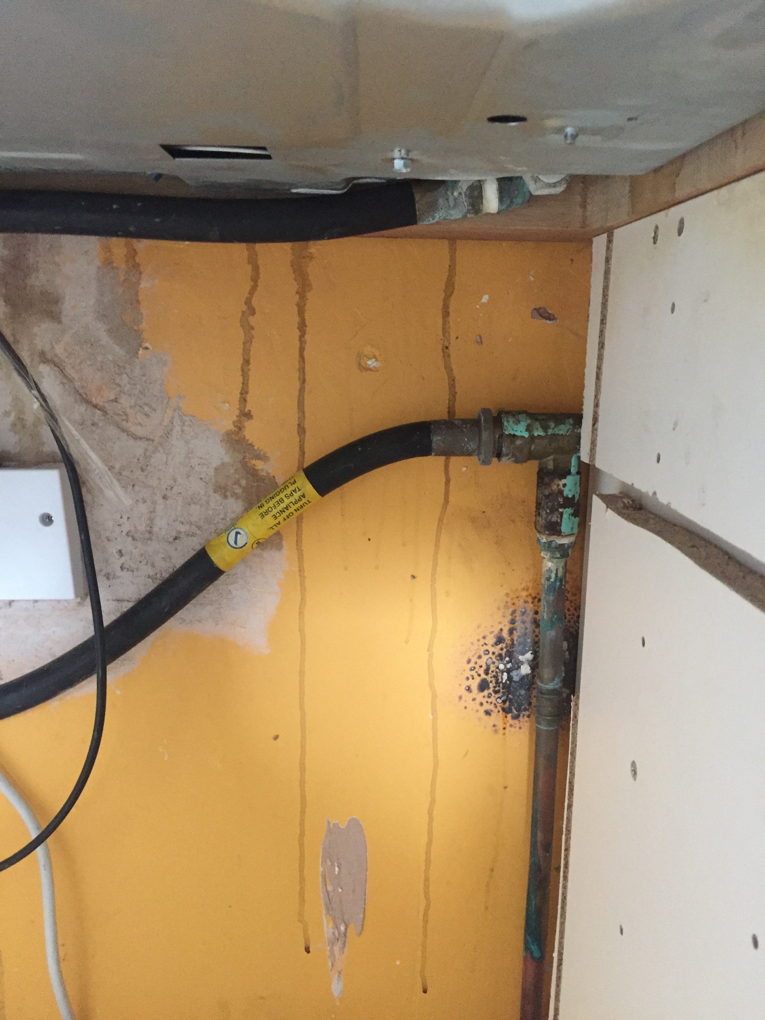

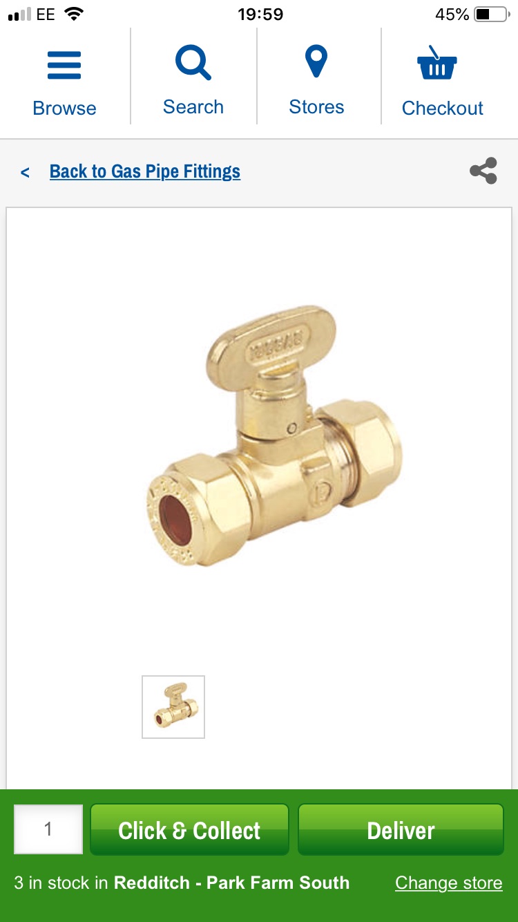

Let’s not start that again Town.Dont forget a gas cock , waste of bloody time though .
This you mean?Dont forget a gas cock , waste of bloody time though .

Clearances. Check mis?

I didn’t think a hob had an ffd? Or am I being stupid?I like the gas ISO’s with test point from Screwfix for hobs

What have you got that’s non flammable?Are the clearances above and to the back and side only for flammable materials? What about a distance at the front of the work top?

Depends what the MIs says. Ive got a Belling in my house that says it can be installed on a flexible connection. I still installed rigid pipework though.
