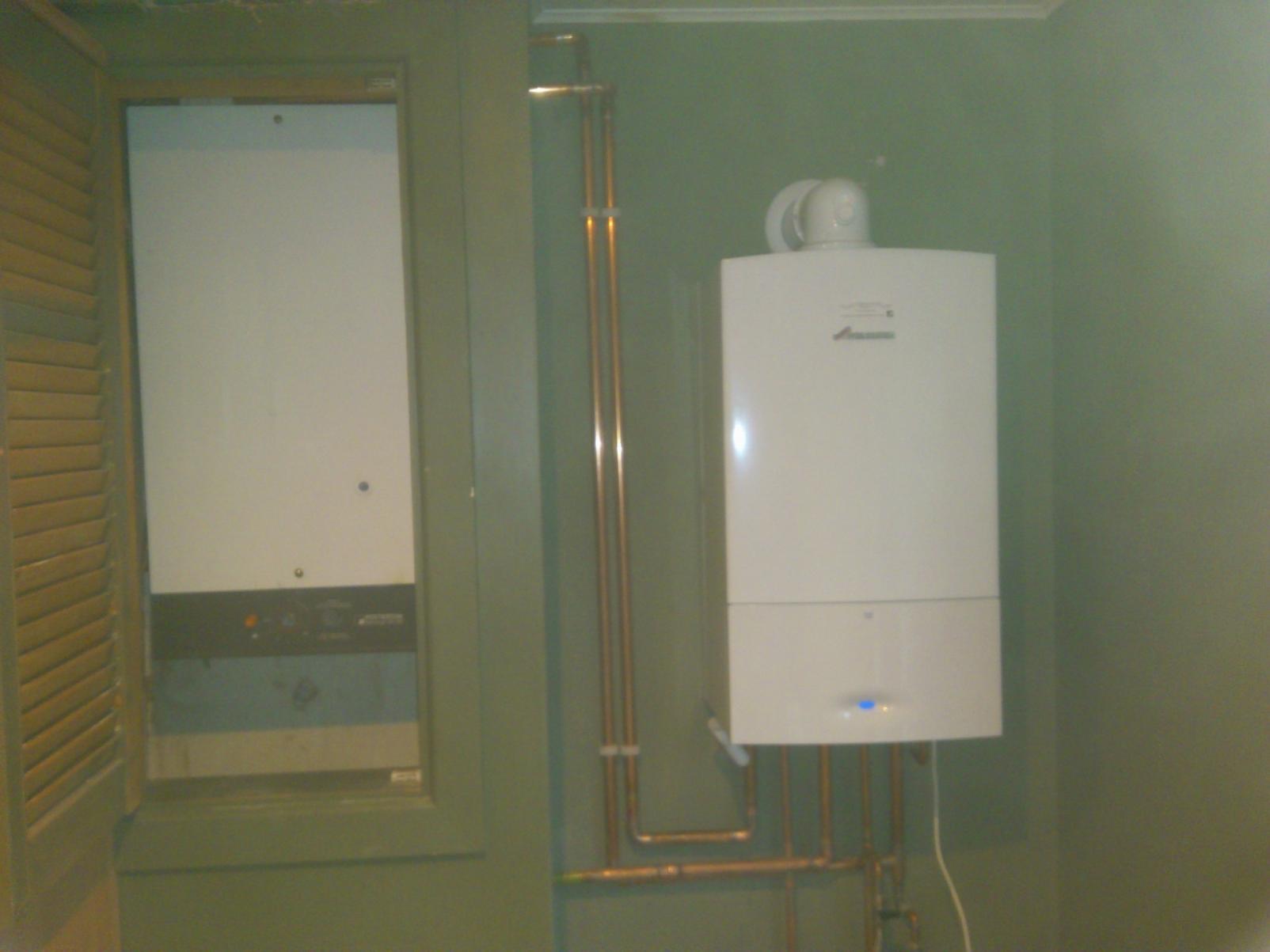

image.jpgI had to leave the old boiler in place as they refused to pay an asbestos company to remove it
looks tidy enough, just clip the cable next time, talk to inspector as stated, remember, all they do to illegals is get them to sign up to gas safe, not even rosecute them at first, so they cant be to harsh on you esp if you want to take advice and rectify your issues. re the custard they should let you have the opportunity to make good any issues foc, if they refuse, then imho why should you pay for someone else to put right work that gas safe will inspect and pass if ok!
I was tought that the flamenco had asbestos in so I get a company to remove it but they didn't wat to pay so it was disconnected perminataly and left in place About the cable it was in to a extension lead for testing there spark was connecting it. The 22 to 15 back to 22 was 8 inches though the wall to out side it is 22 mm from the meter not that far the 15 mm though wall then 5 foot over to boiler this was 15 mm all the way but i changed it to 22 mm I reused the 8 inches though the wall but connected both sides lasy I no regret now but the boiler is running 18 mbr in service mode have I really done a bad job ??
